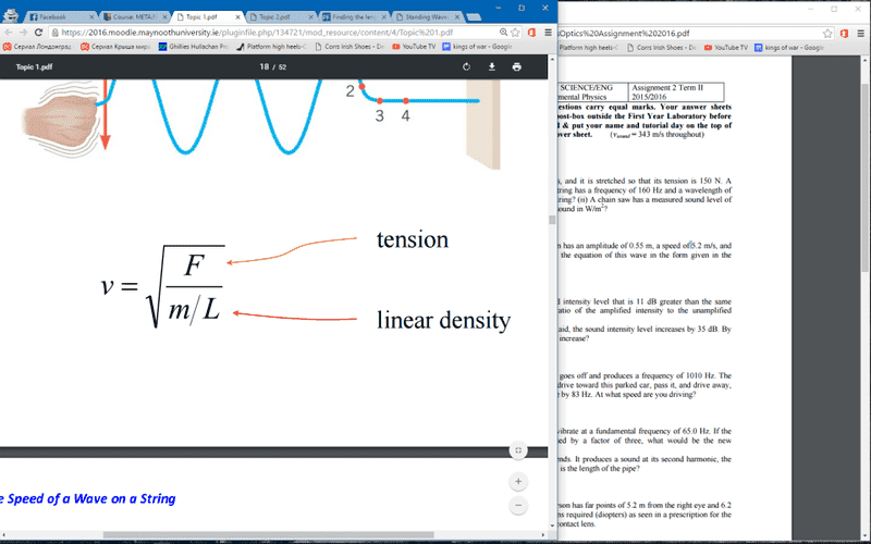

1. Homework Statement
frequency (f)=160hz
Force (F)=150 Newtons
wavelength (λ)=0.40m
mass(m)=6 grams
find the length of a string with these properties
f(λ)=sqrt [F/(m/L)]
found this formula and the statement "solve for L" for this exact question online.
I put the values in above, I believe I interpreted them right.
It seemed a bit dodge to re-arrange, but i got L on it's own to be:
L= [F/(fλ ^2)]/m
(with values)
[150/(160x0.40)^2]/6=0.0061m...I have a feeling I may be off here XD.
romakarol said:
f(λ)=sqrt [F/(m/L)]
What is that equation? The right hand side (RHS) looks like the velocity of waves on a string...
I'm not sure, someone asked the same question as me on some website and that formula along with "solve for L" was the one-sentence reply. I used it because it seems to involve all the values listed in the question and can be used to find L. Is it incorrect?
Edit: see new post
Wait I found a simpler formula based on what you said:
I can get v since the wavelength and frequency is given (wavelength=v/frequency).
So if I re-arrange it to get L on its own, then L=[(m)(V^2)]/F, correct?
