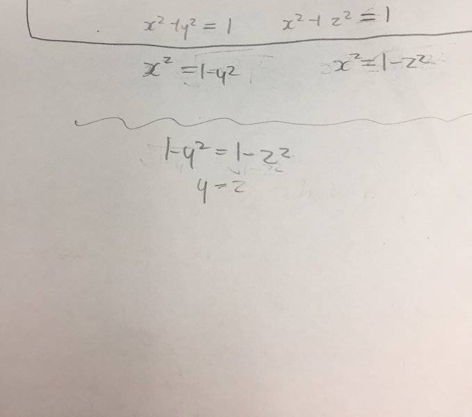

I am looking for the line of intersection of two cylinders (x^2+y^=1 and x^2+z^2=1) to find the curve for a line integral. However, I am getting z=y, which is a patently false answer. Mathematically, it seems to work out though.
x^2+y^=1
x^2+z^2=1

I have not previously worked such a problem, but suggestion is let ##x=t ##. Then ##y=\sqrt{1-t^2} ## and ## z=\sqrt{1-t^2} ##, (omitting ## \pm 's##) will parameterize the curve.

Actually you get y2 = z2, which is somewhat different than y = z .

There is a constraint on what ## x ## is doing that you are disregarding in simply saying that ## y^2=z^2 ##.

The boundary region is a curved line in space. Something like ## y^2=z^2 ## gives you basically a couple of planes in three dimensions.
Generally, curved lines in 3 dimensions are described by ## x=f(t) ##, ## y=g(t) ##, and ## z=h(t) ##. They are parameterized with the dummy variable ## t ##.

You are ignoring the original equations that contain ## x ##. See my post 2 again.

It is correct that ## y= \pm z ## along the curve. In getting this result though, you can't throw away both of the original equations. This is kind of a peculiar system of equations, and I don't have a really good answer for why what you did doesn't work, but it just doesn't...
To look at something that is somewhat related to the type of result you need for this problem, examine what a straight line looks like in 3 dimensions: You will typically see something like ##\frac{x-5}{3}=\frac{y-2}{5}=\frac{z-6}{4}=t ## and this line passes through ## (5,2,6 ) ## and it is in the direction of the vector ## \vec{v}=3 \hat{i}+5 \hat{j}+ 4 \hat{k} ##. You can even normalize this vector ## \hat{v} ## to a unit vector in that direction. ## \\ ## Basically the equation of this line is the parameterization ## x=3t+5 ##, ## y=5t+2 ##, and ## z=4t+6 ##. It might appear clumsy, but we can't do a simple line in 3 dimensions like we do a line in two dimensions. e.g. the equation ## 3x+5y +2z+4=0 ## represents a plane, rather than a line.

@OpheliaM: Your original result that ##z=y## (in the first octant) is correct and tells you that the required curve lies in that plane. Here are a couple of hints:
1. Do you know how to parameterize the ##xy## cylinder in terms of ##\theta## and ##z##, where ##\theta## is the polar angle? If so, then do that and
2. Use the fact that ##z = y##.
That should give you a parameterization in the form ##\vec R(\theta) = \langle x(\theta),y(\theta),z(\theta) \rangle
##, which is the parametric form of a curve.
