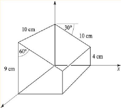

In Fig. 32-9 there is a + x-directed uniform magnetic field of 0.2 T filling the space. Find the magnetic flux through each face of the box shown.

OK. As you calculated correctly, there is flux through the sloping face even though that face is not perpendicular to the field.
I guess you rounded each answer to only 1 significant figure since the data is given to only one significant figure. OK.
Are you supposed to consider the sign of the flux? The entire surface of the box is a closed surface. The usual convention is that flux is considered negative wherever the flux enters a closed region and positive where it exits. With this sign convention, the total flux through a closed surface should be zero when the field is uniform.
