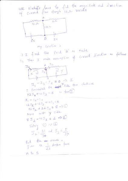

Revered Members,
Please go through my attachment. I have been asked to find the magnitude and direction of current through the 10 ohm resistor. The answer that is given in the book is 1/23 Ampere from A to B.
But i solved as given in the attachment but i got the answer as 5/37 Ampere which is I3...the current which I assumed to pass through 10 ohm resistor. Since Please help me where i went wrong.
