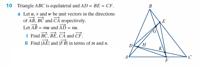

If possible, refer to attached image rather than what's written below (as the image is easier to understand).
Triangle ABC is equilateral and AD = BE = CF.
Let u, v and w be unit vectors in the directions
of AB, BC and CA respectively.
Let AB = mu and AD = nu.
i) Find BC, BE, CA and CF.
ii) Find |AE| and |FB| in terms of m and n.

Well, yes you can draw the triangle onto a grid and plot the points relevant to the question on that graph.
If you draw ##\ \vec{AC}\ ## along the x-axis, then w = -i , the x unit vector. However, unit vectors u, and v are not perpendicular to each other nor to w .The x component of each of these is 1/2 .From that you can find the y-components.
