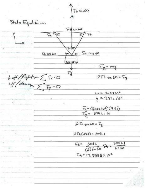

Finding the Magnitude of Force in each of two vines
In summary, a gorilla of mass 310 kg is hanging from two vines, each at a 30° angle from vertical. Using the equations Fg=mg and 2Ft sin60=Fg, the magnitude of the force of tension in each vine is found to be 17.5583 x 10² N.
Scott Towers
A gorilla is hanging from 2 vines, each with an angle of 30° from perpendicular.
Find the Magnitude of the force of tension in each vine.
Object mass is 3.10 x 10² kg
I have made an attempt at this. I have attached my handwritten notes.
Lots of feedback please.
Thank you in advance!
Fg=mg
2Ft sin60=Fg
m = 310 kg
g = 9.81m/s²
Fg = 310*9.81
Fg = 3041.1N
2Ft sin60 = Fg
Ft = Fg/ (2)sin60
Ft = 3041.1/ (2).866
Ft= 3041.1/ 1.732
Ft= 17.5583x 10²
Is that 30° from vertical? If so, you're good!
Yes. I'm sorry. The angle is from vertical.
