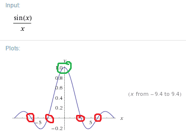

OK I got it. But please correct me if I am wrong:
The formula you posted will give me the red circled values (function when x = 0), and the one I posted gives me the green value (converging value of x)? Just let me know if I'm wrong then I'll look up a book again. :wideeyed:

If you plot y = sin(x) / x with WA, you'll see that this function oscillates quite a bit when x > 0. Your initial guess for x, whatever it was, has led the Newton's method to locate one of the relative minimas, which happens to be located at x ≈ 4.49 rad.
You may have to try different starting points to see what pops out of the Newton's method for this function, since there are a lot of relative extremums, but only one global maximum point at x = 0.

Your formula is correct, since you are trying to solve the equation ##f^{\prime}(x) = 0##. However, you need to start from near the solution, and starting from some points can lead to disaster; for example, starting from ##x_0 = 2## give you ##x_1 \doteq -22.617##, and if you choose another ##x_0## near ##2## you can even make ##x_1 < -10^{100}##. Practical implementations of Newton's method build in various "safeguards" to prevent that behavior from occurring, but they can sometimes slow down the convergence rate.
