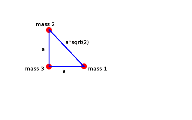

Hi everyone! I'm trying to solve a problem involving 3 equal masses (m) arranged in a 45-45-90 right triangle, each mass connected to the other two by a spring, and all the springs have the same spring constant (k). So it should look like this:
Where I have made a the equilibrium length.
My goal is to set up the eigenvalue equation for its normal modes and find them.

First of all, I set up my generalized coordinates. We are looking at small oscillations, so I define for each mass:
[itex]x_i = x_i ^0 + η_{ix}[/itex]
[itex]y_i = y_i ^0 + η_{iy}[/itex]
Where x0 is the equilibrium distance for that coordinate and each η is the small deviation from the equilibrium length. The index of the masses are as shown in the picture.

To calculate the potential, we can add up the potentials from each spring separately. For the spring between mass 1 and mass 2, I'll call the potential V12, and so on.
So for spring 13, we call its equilibrium length a. Then, if it stretches and turns a little, its new length d is:
[itex]d = \sqrt{(a + η_{1x} - η_{3x})^2 + (η_{1y} - η_{3y})^2}[/itex]
and
[itex]V_{13} = \frac{k}{2}(d - a)^2[/itex]
And this is what I'm talking about...we don't even need to do the potentials for the other springs (though I did). The term with the square root just gets nastier as you differentiate it (twice) to find v. I assume I have to make some approximation to solve this, but I have no idea where... I tried assuming the springs don't turn while they're oscillating, and that makes the potentials V13 and V23 nice and simple (and solvable) but it still leaves V12 complicated and unsolvable.
Can anyone help me?? I'm at my wits end.
Thanks!
You can not spare those derivations, but at the end you should replace all η-s by zero in the second derivatives. Note that taking the derivative of V13=k/2(d-a)2 with respect to a variable u, it is k(d-a)du' and the second one with respect to v is kd'ud'v+k(d-a)d"uv. As your matrix elements are the second derivatives for zero displacements, the second term cancels (d-a=0). So you need to calculate the first derivatives of d only. ehild
Erm...maybe that will work too, but I don't think that's really gets it all. I found that you have to use some approximations, notably
[itex](1 + x)^{1/2} \approx 1 + \frac{x}{2}[/itex]
And also say that powers of eta higher than 2nd order are negligible.
