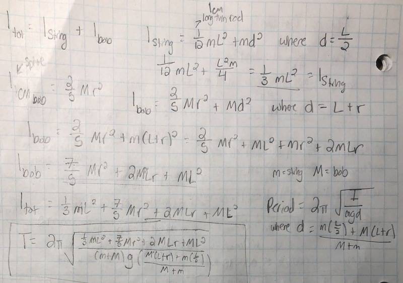

Assuming the string from a simple pendulum did not have negligible mass and the pendulum bob was not a point mass, then determine an expression for the period of a single small-amplitude oscillation, treating the string as a rigid rod.
Theoretical moment of inertia of center of mass for long thin rod = 1/12 mL^2
https://prnt.sc/i02al1 This is what I did but I don't think that it is right
Why not? Check if your equation reduces to the limiting case for which you know the answer, namely massless string and point-mass bob.

solved
