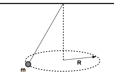

A small mass m is suspended from a string of length L. The body revolves in a horizontal circle of radius R with a constant speed v. Find the speed of the body and the period of the revolution.

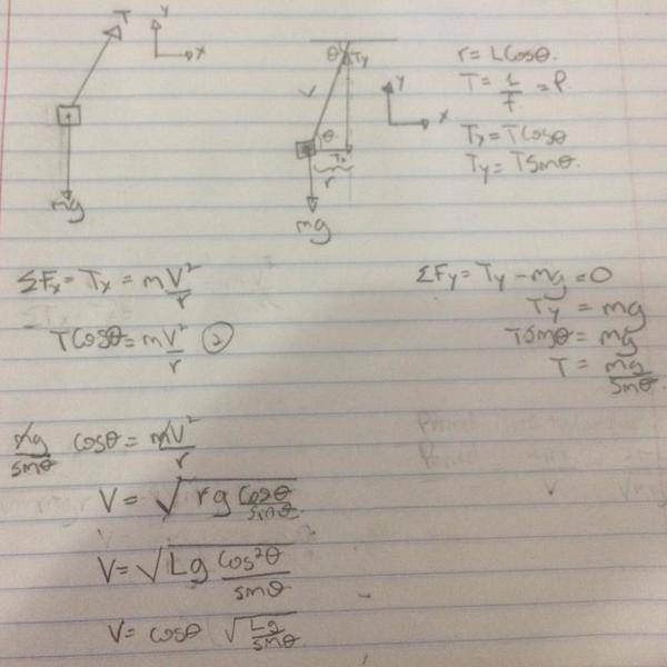

ΣFx = Tx = mV^2/r
Period = (2πr)/V
However, I was told that the velocity is actually √(g*L*Cos(θ)) / tan(θ). Why is my answer incorrect?
Your answer looks correct. If ##\text{tan}(\theta)## is inside the square root, which I assume it should be, then the given answer is identical to yours.
Could you please explain how the answer is identical?
Tan = sin/cos
