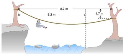

As a stunt coordinator with a background in physics, you have been asked to determine whether Man can make it across the river and whether the rope will hold his weight. Man is rather small, with a mass of only about 48.7 kg, including his equipment. The crossing distance is roughly W = 8.7 m and the rope is tied H = 1.7 m lower on the opposing the bank. Judging by the sag in the rope, its length is about 11.5 m. Calculate the tension in the rope once man reaches a point of equilibrium. Assume the rope does not stretch.

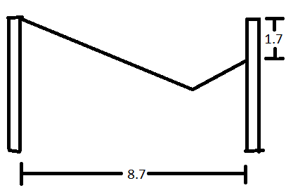

Also here's a diagram i drew, i imagine the rope would look like something like this at equilibrium.

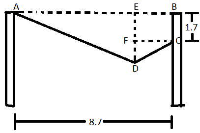

It helps to add labels and construction lines. In you diagram, call the tops of the posts (same height) A (left) and B; the rope attaches at points A and C; the lowest point of the rope is D. Draw a vertical up from D to meet AB at E. Draw a horizontal from C to meet DE at F.
Now everything is reduced to rectangles and triangles with known angles. Using AED, what is length DE? Using CDF what is length DF?
so i redrew the diagram
problem is i don't understand how you can find the length of DE without knowing the length of AE. If for some reason you want me to use the length "6.2m", how would i know that's the equilibrium point? I probably should i said this in my original post but that length "6.2m" is used in the 2nd part of the question asking if the man can make it across the river and onto land.

see what equations you can come up with to relate the various lengths. You could start by letting AE be x and see what expressions you can come up with for other lengths using x and the unknown angle to the horizontal. You should get enough equations to solve for x and the angle.
would
x tanθ = DE
and
DF tanθ =FC
be a good place to start? I'm kinda going in loops here.

You should also be able to write down simple relationships between DE and DF and between x and FC using the given lengths.
There is another given length that you need to make use of.
For DE and DF
We know the length of BC, which is the same length as EF
So...
DE-EF=DF
For x and FC
We know the length of EB is going to be the same length as FC, and AB is given
so can we say
AB-FC= x?
DE-EF=DF
Yes, and you know EF.
AB-FC= x?
Yes, and you know AB.
What given length have you not got into an equation yet?
the rope?
would it be legal to add two lengths even though they meet at a corner?
so would it be...
AD+DC=AC
the rope?
so would it be...
AD+DC=AC
No, "AC" would mean the straight line connecting them. But AD+DC= length of rope.
So are these the only equations i need to solve this?
DE-EF=DF
AB-FC=x
X tanθ=DE
AD+DC= rope
If so I am curious as to how i can incorporate the rope length since its not a straight line
DE-EF=DF
AB-FC=x
X tanθ=DE
AD+DC= rope
Relate AD to x and theta. Similarly DC.
