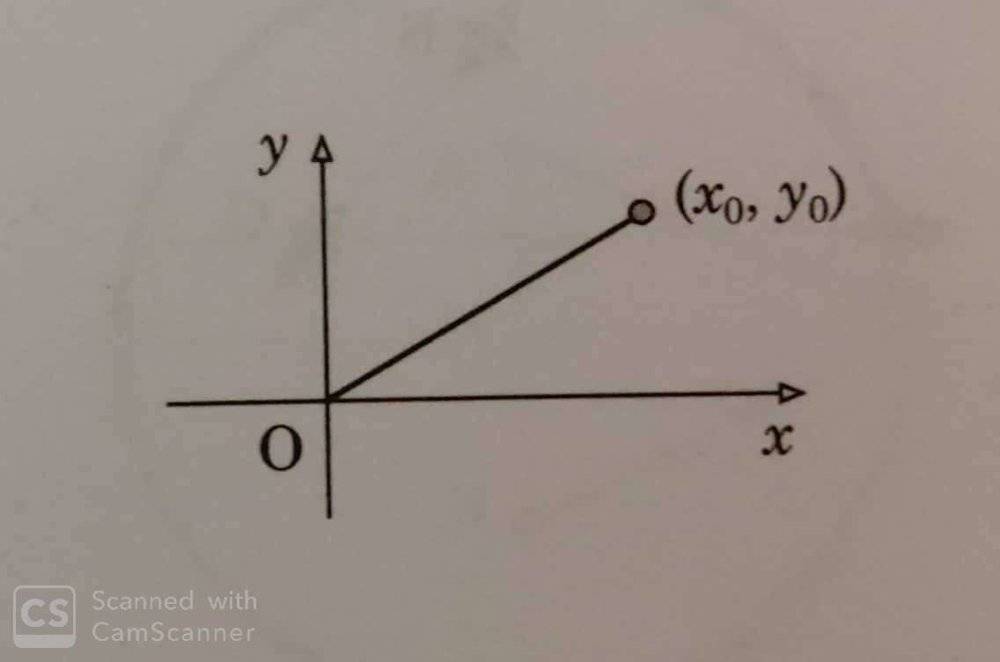

A particle of mass m is connected from the origin O of an inertial frame with the help of an elastic cord of force constant k and negligible relaxed length. In addition to the elastic force of the cord, a constant force F=F î also acts on the particle.The particle is pulled to an arbitrary position (x0,y0) as in the figure and released.Find the position between which the particle oscillates and period of the oscillations.
a=-(ω^2)x
T=2π/ω

Did you find the equation of motion?
A suitable coordinate transformation should get rid of the external force.

Did you ever get round to deriving the equations of motion?
I tried deriving the equation but with no success. I am a high school student. Can the equation of motion be derived with my limited mathematical knowledge ? But this problem is from a high school physics olympiad book.

Show us how much you can do. What if we ignore ##F## for the moment? Could you derive the equations of motion in that simplified case?
In that case x=x0cos(ωt) and y=y0cos(ωt).

But, how did you derive those? If you simply quote them, the problem is what do you do if something is slightly different. You need to understand where those solutions come from.
The net force acting on the particle at (x,y) is k√(x2+y2) .
F=k√(x2+y2)
The component of this force along x-axis is Fx
Fx=k√(x2+y2) * x/√(x2+y2)=kx.
From this we can infer that the x coordinate is oscillating. Amplitude is x0. At t=0 x=x0 therefore x=x0cos(ωt).
Similarly we can derive y0cos(ωt).

What if you add the constant force ##F## to those equations?
Then there would be no change in the the time period since F is a constant.

That's not a mathematical analysis; and, it doesn't produce the full solution. Just add it to your equations.
Fy=-ky
Fx=-kx+F

Can you write Newton's second law based on these equations? These would be the equations of motion.
max=-kx+F or m d2x/dt2=-kx+F
may=-ky or m d2y/dt2=-ky

This is correct. Once you take an elementary differential equations course you'll realize these are extremely simple to solve without worrying about any "coordinate transformations". I must admit that without this background it's perhaps too involved for a high school student. In any case I wouldn't have solved it without that background.
What threw me at first is the requirement that the spring have zero relaxed length. Otherwise it could not have been solved, at least not readily.

It's quite easy. Just substitute x=x'+c, where c is a constant, in your equation and look for a value of c that makes it simpler.

FBD stands for "Free Body Diagram", the acronym is widely used in PF. If one draws a FBD, it is easy to see that there is an equilibrium point at which the net force is zero and with respect to which the net torque is also zero. With respect to that point, angular momentum is conserved and the mass executes one dimensional harmonic motion. The amplitude can be found by energy conservation without solving an ODE. My question was how to interpret "the position between which the particle oscillates". It seems that two position vectors relative to the given origin are required to answer the question and we already know one of them.
One can show by parametrization (eliminating t) that the particle oscillates in a straight line in x-y space. This parametrization with t gives a complete picture of the particle's locus and confirms the observation of post 26.

It is interesting to note that this is the first post in the thread to mention that the stated question includes the task of finding the position(s) between which the particle oscillates.
With the equilibrium position of the system being the point ##\ \left(\dfrac{F}{k} , 0 \right)\,,\ ## the remaining position is easy to find, assuming that the particle is released from rest at position ##\left(x_0 , y_0 \right) ## .

Quite so. Since only the extrema were asked for.
We can derive two equations:
one, conservation of energy between the two extrema (x0,y0) and (x1,y1).
two, net forces along x = 0 at (x1,y1).
That does neatly avoid having to solve the ODEs.
