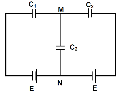

I have been asked to find the potential difference between points M and N in the given figure. The circuit is in the attachment.
Q=CV

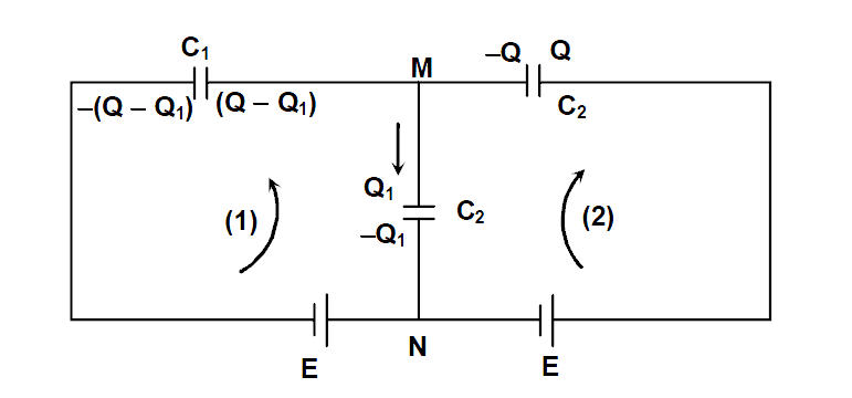

I tried to attempt it by applying KVL to both the loops.
I tried to find a possible charge distribution for the capacitors. I guess this is right.
On solving I get:
from what I know potential difference between M and N is Q1/C2

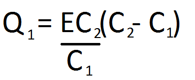

but the solution is given as:
Where am I wrong?

Welcome to PF!
You have a sign error in one of your first two equations.
Likes Gourab_chill
TSny said:
Welcome to PF!
