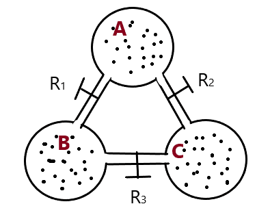

An adiabatic isolated system is formed of three identical balloons (of unknown volume). The balloons are joined by tubes of negligible volume. Each tube has a faucet/tap that is initially closed. The balloons have different quantities of the same ideal gas.
After opening only faucet R1, the system including balloons B and A reaches a state of equilibrium that has pressure p1 and temperature T1.
After opening only faucet R2, the system including balloons A and C reaches a state of equilibrium that has pressure p2 and temperature T2.
After opening only faucet R3, the system including balloons C and B reaches a state of equilibrium that has pressure p3 and temperature T3.
Find the initial pressure of the gas in each balloon (pA, pB and pC).
The drawing:
Also, the book that I'm using has the following results at the end:
pA=p2+p3-p1
pB=p3+p1-p2
pC=p1+p2-p3
PV=nRT
PVγ = constant (adiabatic process)
I tried to apply PV=nRT, but nothing that I did so far worked. I will edit the post if I have any ideas.

What does adiabatic mean for the energy of the system? What is the formula for internal energy of an ideal gas?
Likes Rain10399
After the valve between A and B is opened and the two chambers are allowed to equilibrate, how does the internal energy of the combined system compare with that of the two chambers initially?
Likes Rain10399
It means that the energy is transferred to the surroundings only as work, and the system doesn't transfer Q with its surroundings.
U = nCvT and U = -W (because Q=0).
U1=(nA+nB)CvT= nACvT + nBCvT= UA + UB
OK. Let V be the volume of the three chambers, let ##n_A## be the number of moles in chamber A, and let ##T_A## and ##P_A## be the initial temperature and pressure in chamber A respectively. Same for chambers B and C.
From the ideal gas law, in terms of ##T_A##, ##P_A##, and V what is ##n_A##. Same for chambers B and C.
For the case where the valve between chambers A and B is opened, what is the first law energy balance on chambers A and B between the initial and final states in terms of ##T_A##, ##P_A##,##T_B##, ##P_B##, V, and ##T_1##?
What is the final pressure ##p_1## in terms of ##T_A##, ##P_A##,##T_B##, ##P_B##, V, and ##T_1##?
The change of internal energy is equal to the negative of the work done by the system. But is there any work done on the surrounding if only a valve is opened between two balloons?
Yes, I think so, because the walls of the system are not rigid.

Write up the internal energy of the system consisting of vessels A and B before and after joining them.

This part was not correct, because the walls of the chambers are supposed to taken to be rigid, so no work is done on the surroundings.
(nA+nB)CvT1= nACvT1 + nBCvT1
That's more like it, but it is not quite correct yet. The equation should read:
$$(n_A+n_B)C_vT_1=n_AC_vT_A+n_BC_vT_B$$
What do you get if you substitute your equations for ##n_A## and ##n_B## into this equation?
Likes Rain10399

So because there's no heat exchanged and no work done the internal energy remains the same? I think I understand this part now:D
Then U1=UA+UB and (nA+nB)CvT1=nACvTA+nBCvTB, like Chestermiller said

Thank you! I tried again
$$(n_A+n_B)2P_1V/R(n_A + n_B)=n_AT_A+n_BT_B$$
$$2P_1V/R=P_AVT_A/RT_A + P_BVT_B/RT_B$$
$$2P_1V/R=(P_A + P_B)V/R$$
$$2P_1=P_A + P_B$$

Great. This should be enough to enable you to complete the solution.
Likes Rain10399
Yes, now I managed to solve the problem! Thank you so much to everyone who responded ^^. I love this forum.
