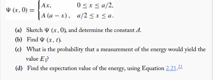

See attached. This is from Griffiths 3rd edition quantum mechanics textbook, problem 2.7:
This is the solution for an infinite square well. I am to find the probability of obtaining E1 where En = n^2pi^2hbar^2/2ma^2.
E1 = hbar^2pi^2/2ma^2
When finding the amplitude of this wavefunction from normalization you will see that it is independent of n. Therefore the probability of measuring E1 is the amplitude squared which is the same for all energy eigenvalues. Is this correct?

Of course, it's independent of ##n##. Why should the state depend on ##n##. It's representing the state the particle is prepared in. The question now is, what's the probability to measure the energy eigenvalue ##E_1## when you measure the energy.

No, that's not correct. You need to express the wavefunction you are given in the energy eigenbasis. Or, at least, find the coefficient of ##\psi_1## when expressed in this basis.
Hint: Fourier's trick.

It seems to me you approximately know what needs to be done, but don't fully grasp the all-important concept of eigenfunctions
You have a ##\Psi(x,0)## given and you know the solutions for the time independent Schrödinger equation ##H\Psi(x) = E\Psi(x)##. The solutions (eigenfunctions of ##H##) have energy ##E_n##, so $$H\Psi_n(x) = E_n\Psi_n(x)\ .$$
You know the time dependence of the eigenfunctions is $$ \Psi_n(x,t) = \Psi_n(x) \,e^{-i\omega_n t} $$ with ##E_n = \hbar \omega_n##.
The Schrödinger equation is linear, so if you can write your given ##\Psi(x,0)## as $$\Psi(x,0)=\sum C_n\Psi_n(x)\ ,$$ then you have $$\Psi(x,t) = C_n\Psi_n(x) \,e^{-i\omega_n t} $$
You determine the ##C_n## from ##\Psi(x,0)## by evaluating the integrals $$\int_{-\infty}^{+\infty} \Psi_n^* \, \Psi(x,0) \; dx\ ,$$which in this exercise means evaluating Fourier coefficients.
Can I ask you to confirm that you understand all this ?
[edit] I notice I used all uppercase ##\Psi##, where Griffith is more clear and uses lower case for the eigenfunctions.

Excellent. So, where are we in this exercise ?
  1. ##A## is determined
  2. An expression for ##\Psi(x,t)## is found
  3. The probablility to find ##E_1##
  4. <Energy> of ##\Psi(x,t)##
