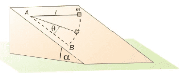

Find v(θ), the dependence of the speed of the object on the angle θ. The string is ideal and there's no friction.
I'm quite sure I should use the conservation of energy mgh = mv2/2, but I don't know how to express h with the help of the angle θ

Can you express position on the surface of the inclined plane in terms of the angle? Lay down a coordinate system on the surface of the plane if it helps. I would suggest anchoring that coordinate system, putting its origin at point A.
Edit: Your approach of using conservation of energy will work. As you say, the problem is figuring out height as a function of angle.

I laid down the coordinate system on the surface of the plan at the origin A, but I didn't manage to express the first position of m in terms of the angle θ. I drew a straight line between the first position of m and B, but the triangle with the angle θ in it is not right, so I'm not sure how to proceed from there.
The starting position is "l" over and zero down.

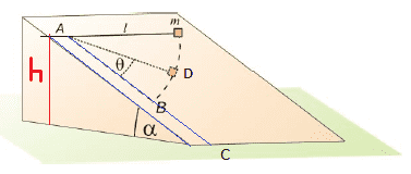

So I found h = sin α * AC, and now I'm trying to find AC in terms of angle θ.
I thought mass m was on a string. Why is AC relevant?
Likes Rain10399
I'm trying to find the height at which is m in terms of angle θ, so that I can replace h with the angle in formula mgh = mv2/2. I don't know how else to solve the problem.

The relevant height h is above (or below) what baseline?
The relevant height is from the base of the plane to the position of A or to m's initial position (which have the same height)
That is incorrect.
You should be working on a conservation of energy argument. You know the kinetic energy at the starting point. You know the change in potential energy between starting point and ending point.
Whether the entire plane is on a table, on the floor or on the roof of a building is irrelevant.

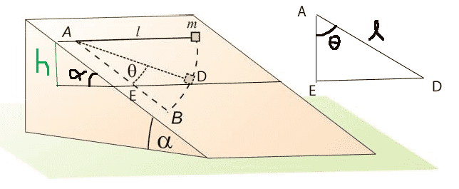

You want to know how much potential energy has changed between the starting point and the ending point. The height difference between starting point and ending point would be of some interest.

So can h be the difference between A and D (or E. D and E are supposed to be at the same height, but I'm not sure if that can be seen on the drawing)? Then h = sin α * AE and AE = cos θ * l.
So mg * sin α * cos θ * l = mv2/2, and from there I can express v in terms of θ.
However, I had to make he assumption that AED is a right triangle in order to express AE in terms of θ.
Seems a reasonable assumption. You are measuring the angle from a reference that we assume is directly downslope. The horizontal lines across the slope will be at right angles to this.
Likes Rain10399
Oh, yes, you're right.
Thank you for helping me with this problem!
