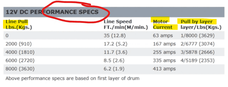

Another thought: you can measure the actual peak loads when yanking a vehicle if you have access to a high speed accelerometer and data acquisition system. Knowing the mass of the pulling vehicle, and measuring the acceleration and velocity vs time, you can calculate the spring constant. Such a test will need an immovable load, such as a dump truck or big tree. The accelerometer will need about 1000 Hz bandwidth and the data acquisition system a sample rate of 1000 samples/sec.
Likes B0B and topsquark
I can probably get a current vs pull table for my winch link this one provided by Warn
I can easily measure current. I'll use single line pulls on the first layer of the capstan up to 8K lbs, then switch to using a snatch ring for up to 16K lbs. I have several snatch rings so I could go even higher using my 12K winch.

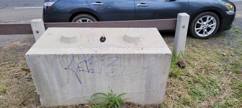

Now to the test procedure. For the two immovable objects I'll use a combination of large tree and Jersey barrier. I'll attach a winch dampening blanket to the non-winch end of the line. The back of the Jeep will be anchored with my 4" 30' 40K BS tow strap anchored at two points which yields approximately 80K BS. While tow straps are elastic, they don't stretch much. Hopefully I can ignore the error introduced. Unless it's around a tree, I'll use my 56K soft shackle in the connection.
I'll measure the stretch at 2K, 4K, 8K, and 10K using a snatch ring on my 12K winch (yielding 2*cos(alpha/2) pull, where alpha is the angle of two rope segments). I should probably make a 3/4" plywood barrier given I'll need to be near the winch line to measure the current. Perhaps a double winch blanket would be enough.
