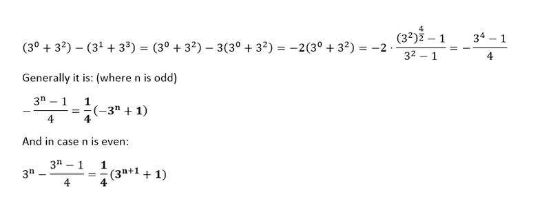

Hi!
If I have a sequence that its first 4 terms are:
30, -31, +32, -32
The pattern is geometric sequence but has alternating signs..
How can I find its sum ..
I know it is composed of 2 sequences ..
However, when I try to separate the 2 sequences .. I get them of different "lengths"
In other words, it is (30+32+34) - (31+33) for 5 terms
but for 4 terms I get:
In other words, it is (30+32) - (31+33)How can I get general formula for both ..
(-1)k helps ! but how! and what about the number of termsThanks!

Further to my previous post ..
This is the book's answer:
When ##n## is odd that is ##n=2m+1## you obtain ## \frac{1}{4}(-3^{2m+1}+1)##, when is even ##n=2m## you obtain ## \frac{1}{4}(3^{2m+1}+1)##. In order to obtain both you must have ## \frac{1}{4}((-1)^{n}3^{n+1}+1)## (this is obtained merging the two previous...)
If you set ##n = 1##, then your formula gives ##S = -1/2##
