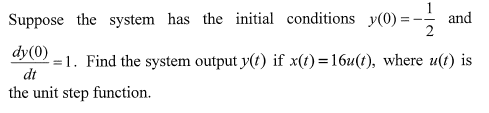

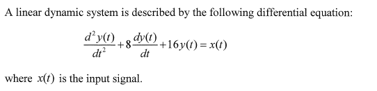

As attached below.
Since there are initial conditions stated, I would have to craft the s equation in mind, in order to find the impulse by laplace inverse; which is this:
##(s^2Y(s)-sy(0)-y'(0))+8(sY(s)-y(0))+16Y(s)=x(s)##
##(s^2Y(s)+\frac{1}{2}s-1)+8(sY(s)-1)+16Y(s)=x(s)##
##Y(s)(s^2+8s+16)+\frac{1}{2}s-1-8=x(s)##
##\frac{Y(S)}{X(S)}=\frac{1}{(s^2+8s+16)+\frac{1}{2}s-9)}##
Now is this even correct(before I move on to the next step of finding the output)? It seems pretty messed up to me, but I can't figure out what is wrong here :( Please help, thanks.
You are correct so far. You might want to further simplify the denominator e.g. +16-9=7.
It looks like you plugged in the wrong value for ##y(0)## in the Laplace transform of the ##y'## term.

No, you didn't do the algebra correctly. You should get
$$Y(s) = \frac{X(s)}{s^2+8s+16} - \frac 12 \frac{s + 6}{s^2+8s+16}.$$

Thanks for your reply. After some figuring out, I realized that the steps that I did beforehand was unnecessary as to find the transfer function, my initial conditions has to be set to 0 in the first place.
Hence setting the initial conditions to 0,
##\frac{Y(S)}{X(S)}=\frac{1}{(s^2+8s+16)}##
Spilitting into partial fractions (in order to perform a Laplace universe to findimpulse function, I get):
##\frac{Y(S)}{X(S)}=\frac{1}{(s+4)^2}##
Inversing it will give me : ##e^{-4t}t##

No. You need to be more careful. The limits are wrong. The integration variable is wrong. ##t-\tau## doesn't appear in your integral.
You will still have to deal somehow with the initial conditions.

Since X(t) = 16u(t), X(s) is simply 16/s
By subbing that in the equation above, I got Y(s) =
And I inverse it to find the output Y(t) =
Is this correct?
If so, how do I determine if the system is stable? Cheers
You can check your answer by plugging your solution back into the differential equation.
