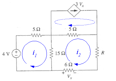

Find resistance R so that maximum power is transferred to this resistor.
http://i.imgur.com/XsxTFCq.png
Rth = Voc/Isc
I tried to find the Thevenin equivalent circuit across the resistor R because the Thevenin resistance must be equal to the load resistor in order for maximum power to be transferred.
I replaced R with an open circuit to find the open circuit voltage.
Using Nodal Analysis, I obtained the equation: (V1 - 4V)/5 + V1/15 = 0
So, V1 = 3 = Voc.
Then I redrew the circuit and replaced R with a short circuit and solved for two voltages at the nodes.
http://i.imgur.com/247x27x.pngI used Nodal Analysis and obtained two equations.
[3Vx = V2/6]
(V1-4V)/5 + V1/15 + V2/2 + (V1-V2)/5 = 0
V2/6 + (V2-V1)/5 = 3V2/6
I got V1 = 48V, V2 = -72V and Isc = V2/6 = -12A
so I got Rth = 3/-12 = -0.25 ohms.
This isn't right, but I"m not sure what I did wrong.

OK, I missed the fact that the current source is dependant.
It's for the wrong circuit because it's not across the load resistor.
How is it not for the load resistor? Doesn't the TEC process involve removing the component and measuring the voltage across an open terminal and current through a short circuit?
Removing the load resistor does not mean shorting it out, it means leaving it open. Also, in your redrawn circuit, I'm assuming you are finding the equivalent circuit between the nodes you have labeled V1 and V2. This is not across the load resistor.

You might find it easier to use mesh analysis on this circuit. One of the meshes has a constrained current which is wholly dependent upon the current in the "output" loop. So you have two loop currents to solve for, and you only need one of them.
The voltage across the load resistor is ##i_2 R##. Rearrange the resulting expression to the form of a voltage divider and pick out the Thevenin model components.

1) The circuit remains intact so you don't have to worry that removing the load alters some "dependent" characteristic of the circuit. For example, in this circuit opening the load "kills" the sensor that defines Vx and disables the dependent current source. So no fiddling about with applying external sources to stimulate the circuit.
2) You need to solve only once to obtain both Vth and Rth at the same time.
How's that? :smile:

No, the mesh equations have two unknowns: the currents in the two lower loops. The current in the upper loop is entirely determined by the current in the lower right loop, since its "sense" resistor is located there. It's a straightforward substitution as you write the loop equations.
The "by the book" procedure for finding the Thevenin model is to: 1) remove the load and find the open circuit voltage presented at the open terminals, and 2) Either determine the equivalent resistance with the sources suppressed, or short-circuit the output and determine the short-circuit current, with the Thevenin resistance will be given by ##V_{th}/I_{short-circuit}##. All of the above can be foiled by dependent sources that get disrupted by interfering with the load.
In order to find Rth your teacher had to insert the external 1A source in place of the load in order to "stimulate" the circuit's dependent source, a procedure I alluded to before. By leaving the circuit intact and solving the mesh equations you can avoid that...
If you think about the form of a Thevenin equivalent model with a load attached, it forms a classic voltage divider: a voltage source with a series resistance and a load. The equation representing such a situation is
$$ V_{load} = V_{th}\frac{R_L}{R_L + R_{th}}$$
After you solve the mesh equation for the current through the load you multiply by the load resistor R to find the load voltage. The resulting expression can be arranged in the same form as the voltage divider equation above, and the Thevenin voltage and resistance read directly from the equation.
You could also use nodal analysis. Any method that will let you solve for the voltage across the load resistor R will do. I picked mesh analysis largely due to experience... the load current through R is identical to one of the mesh currents, so no fiddling about later to calculate the current from node potentials.

Your professor didn't indicate on his schematic for the Rth calculation where his reference node (ground) was, but it's apparently the left end of the 6 ohm resistor. The voltages V1 and V2 are calculated with respect to this node. When he calculates V2/I, he is not using the voltage across the 1 amp source he applied in place of the resistor R; rather, he is using the voltage across the series combination of the 1 amp source and the 6 ohm resistor.. Furthermore, he didn't set the 4 volt source to zero for this calculation, either. Thus, he gets the wrong value for Rth.
If the calculation is done without these two errors, a value of 104.75 ohms is obtained for Rth.
