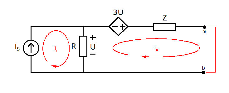

I'm having some difficulty understanding how to go about solving the following problem. I'm a beginner at this and am completely lost. I've seen a few similar problems that could be solved with node/current analysis, but I don't really understand if or how to apply that here.
Can someone please help me?
From the attached image:
Is = 2.0∠0° A
R = 10[itex]\Omega[/itex]
Z = j10[itex]\Omega[/itex]

Hi butchsd, Welcome to Physics Forums.
You'll have to show some attempt at the problem before we can see how to help you. At the very least you can describe your understanding of Thevenin (and Norton) equivalents, the 'usual' procedure for finding them, and why this particular circuit is giving you difficulty.
One hint that you might find useful here and in future is that for a given circuit, if you divide the Thevenin voltage by the Norton current you get the Thevenin (and Norton) impedance.

Yes, you do need to take the 3U voltage source into account. This will affect your open circuit (Thevenin) voltage since the 3U source is in series with the 'a' lead, boosting the output potential even if no current flows through the branch.
Your results so far are not correct, but you've demonstrated that you're putting in some good effort and thinking creatively about the problem. I'm not sure precisely what you had in mind by having "two Nortons in series". Perhaps you can include a diagram?
Another approach would be to insert the a-b short and do a mesh analysis; there are two loops but the first has its mesh current constrained by Is and thus is already 'solved', so you can concentrate on writing the mesh equation for the second loop; its current will be the Norton current for the circuit...
With the Norton current and a (correct) Thevenin voltage in hand, you can then calculate the Thevenin impedance.

Let's give the mesh analysis a try. So if I solve the mesh analysis for IN I get this:
IS: IS = 2.0∠0° A
IN: -R(IS-IN) - 3U + ZIN = 0
Ohm's law:
-R(IS-IN) - 3R(IS-IN) + ZIN = 0
-4R(IS-IN) + ZIN = 0
Factor into IN and IS:
(4R+Z)IN = 4RIS
IN = 4RIS / (4R+Z)
IN = 4*10*2.0∠0° / (4*10+j10) = 80∠0° / 41.231∠14.04° = 38.769∠-14.04° A
After this I'm a bit confused. Are you saying that the 3U source affects the open circuit voltage over R even though a and b aren't shorted? If so, how? I can't find anything about this in the textbook I'm using.
Not the voltage over R, but the voltage (potential difference) between terminals a and b. The potential at a is equal to the potential at the top of R plus the potential across whatever lies between that point and terminal a. The voltage source 3U lies between...

As explained above, you've got to take into account the 3U source when you determine Voc.
gneill said:
Check your math in the line above. 80/41 is not close to 38...
Ah yes, my mistake. That should be 1.940∠-14.04° A

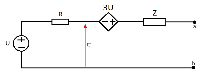

Incidentally, can't I rewrite the problem like this?
If so, I think I can add the sources to calculate Voc:
Voc = U + 3U = 0.118 - j0.471 + 3.552 - j14.141 = 3.670 - j14.612 = 15∠-75.9°

Ooops. For Voc, terminals a-c are open so there will be no current IN in the above.

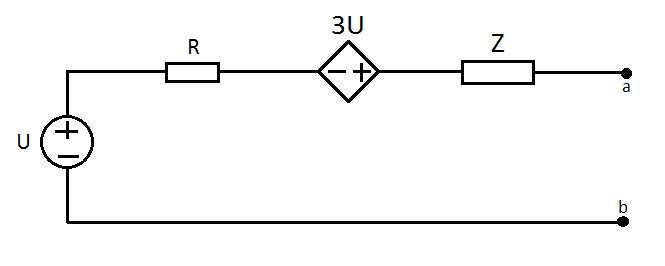

Not quite. When you transform a circuit using an equivalent model the components are no longer the same components as the original and the "internal" parameters of the model do not necessarily correspond to those in the original circuit. Thus the 'R' in the Thevenin model is not the same as the 'R' in the original, and you can't trust the current through it or the voltage across it to be the same as in the original.
Mind you, if you keep track of the original nodes where the R was attached and use the potential between them as U, then you'll be all right.
Ok, so U would be R*IS = 10*2∠0° = 20∠0° V
That makes 3U = 3*20∠0° = 60∠0° V
Yeah let's just disregard the thevenin thing I tried. :)
Voc = 3U + U = 4U = 4*20∠0° = 80∠0° V = 80cos(ωt) V
Zt = Voc / IN = 80∠0° / 1.940∠-14.04° = 14.237∠14.04° Ω ≈ 40+j10 Ω
