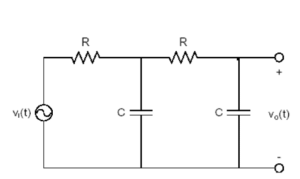

1. Find the transfer function of the following circuit. The circuit has been included as an attachment. I have tried using node voltage, which leads me to this equation:
(V1 - Vi)/R + V1/C + (V1-Vo)/(R+C) = 0
*V1 is the voltage of the essential node on the top center of the circuit.
I thought this would work but I am having trouble finding a way to get the Vo/Vi ratio. I know the C values need to be converted into the S-domain, but that isn't what I'm confused about. Any suggestions?

You would have to solve your equation for the node voltage V1, then treat the final RC combination as a voltage divider to find Vo in terms of Vi.
Alternatively, treat Vo as another node and write two equations. Solve for Vo.
Ok, so I'm trying the idea of treating Vo as another node, but how exactly would that work?
Would the new equation be this:
(Vo-V1)/R + Vo/C = 0 ?
This is the only way I could think of making an equation using this method, but I'm 99.9% sure that's wrong. Could you help me out?
That looks fine. You'll have to re-write the last term in your first equation, too, in order to take into account this new node.
The idea is that you will have two equations in two unknowns, V1 and Vo. Solve for Vo.
Ooooohhhhh, I didn't know I would need to adjust the first equation. Now it makes sense. Thank you!
