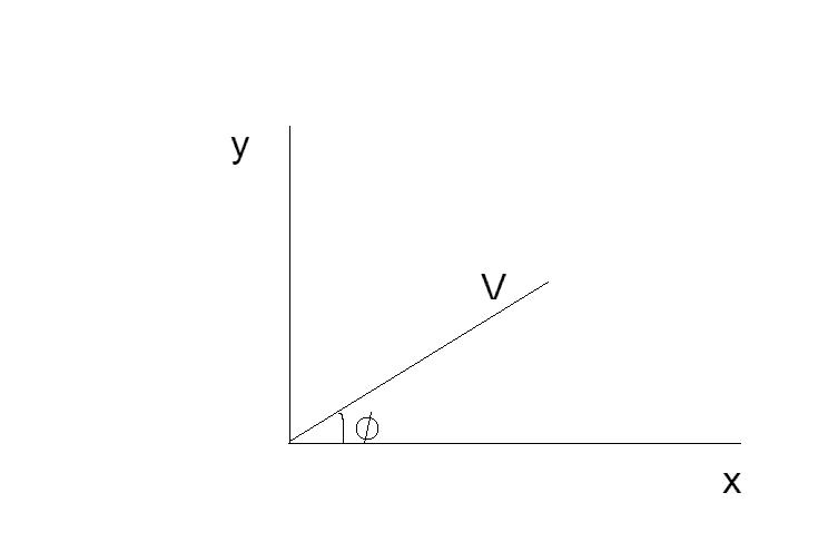

For a vector ##\vec{v}##
##v_x' = v_x cos \theta + v_y sin \theta##
##v_y' = v_x sin \theta - v_y cos \theta##
If ##\phi## is the angle between x-axis and the vector ##\vec{v}##, then ##v_x = r cos \theta ## and ##v_y = r sin \theta##
Thus,
##v_x = r cos \phi cos \theta + r sin\phi sin\theta## = ##r cos(\phi - \theta)##
##v_y = r cos \phi sin \theta - r sin\phi cos\theta## = - ##r sin(\phi - \theta)##
From that, the transformation seems to be an rotation of ##\phi - \theta## clockwise and then a reflection over the x axis. Is this correct?
Where did ##\phi## come from?
Between x and ##\vec{v}##

What has that to do with a matrix that is a function of ##\theta##?

##\vec{v}## is an arbitrary vector to help me figure out what the matrix does.

I understand that, but what the matrix does can only depend on ##\theta## and not on some other angle. I'm struggling to see how another angle could be involved in the general matrix operation.
PS if you know how to write the rotation and reflection matrices, then you can check your answer. Do you know how?

I watched youtube videos and they use the same way as I did to find the rotation matrix. A vector ##\vec{v}## and an angle ##\phi## between x and ##\vec{v}##. Otherwise, I don't know.

When you say "a clockwise rotation of ##\phi - \theta##", what does that mean?

##\theta## is the angle between ##\vec{v}'## and the x axis.
Thus. ##\phi - \theta## is the angle between ##\vec{v}## and ##\vec{v}'##.
##\vec{v}'## is closer to the x axis.
Is it clear?

This is not right. The matrix you have is a reflection in the ##x## axis followed by a rotation by ##\theta##. By convention rotations are anti-clockwise.
Alternatively, it's a rotation of ##-\theta## followed by reflection in the ##x## axis.
There's no ##\phi## involved, regardless of what you've seen on Youtube.
The other thing you are missing is that you can use matrix multiplication to generate a rotation followed by a reflection or vice versa.
That's how you could have checked your answer.

There's no need to involve ##\phi##. The video you saw has confused you. It's possible to represent a vector using a polar angle ##\phi##, but that is ultimately irrelevant to the matrix itself.
