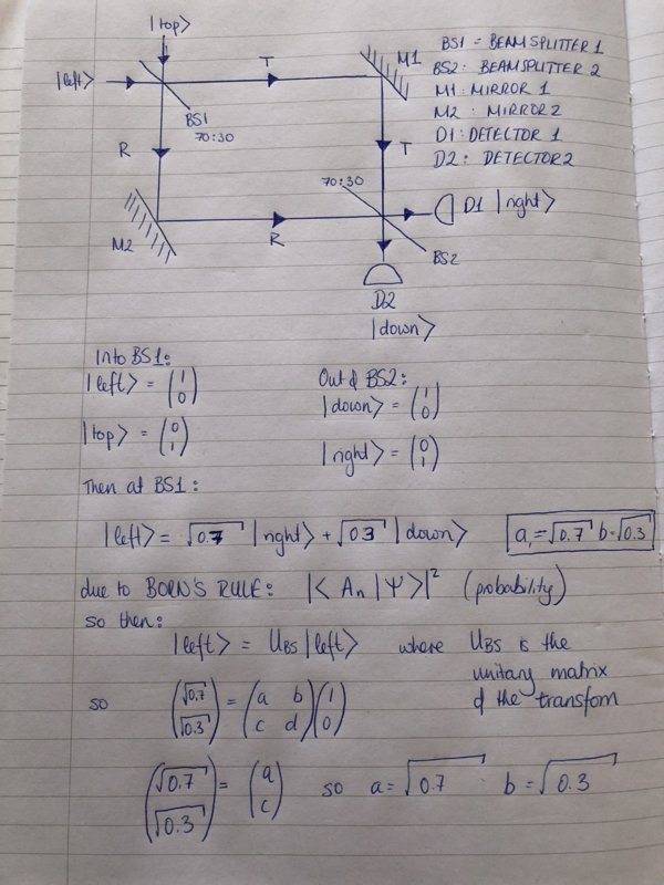

Hello,
I have some trouble understanding how to construct the matrix for the beam splitter (in a Mach-Zehnder interferometer).
I started with deciding my input and output states for the photon.
240971

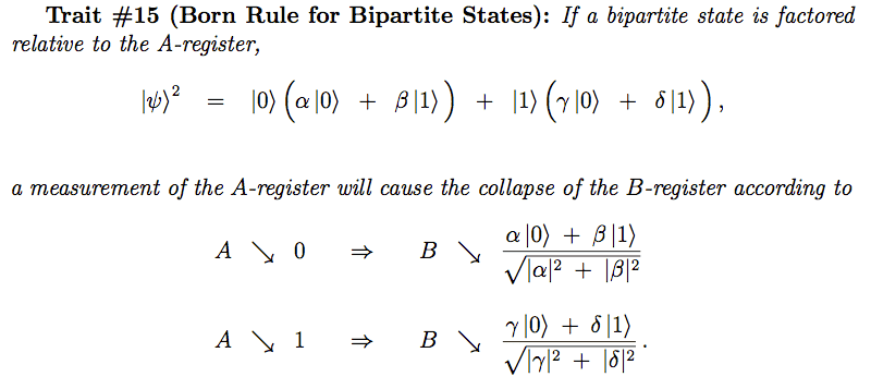

I then use Borns rule, which I have attached below:
240970
To get the following for the state space of the photon going in:

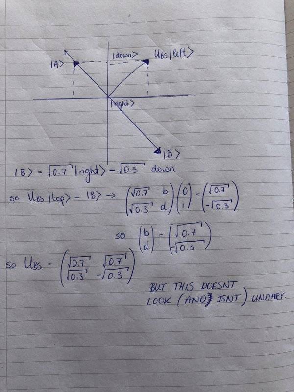

But in the end, I end up with a matrix that doesn't appear unitary:
240975
I don’t know where I’m going wrong. We’ve only just started doing Quantum and the lectures are quite difficult for me to understand. I would appreciate any help and advice as I really would like to be able to do these types of questions as I suspect they will be in my exam!

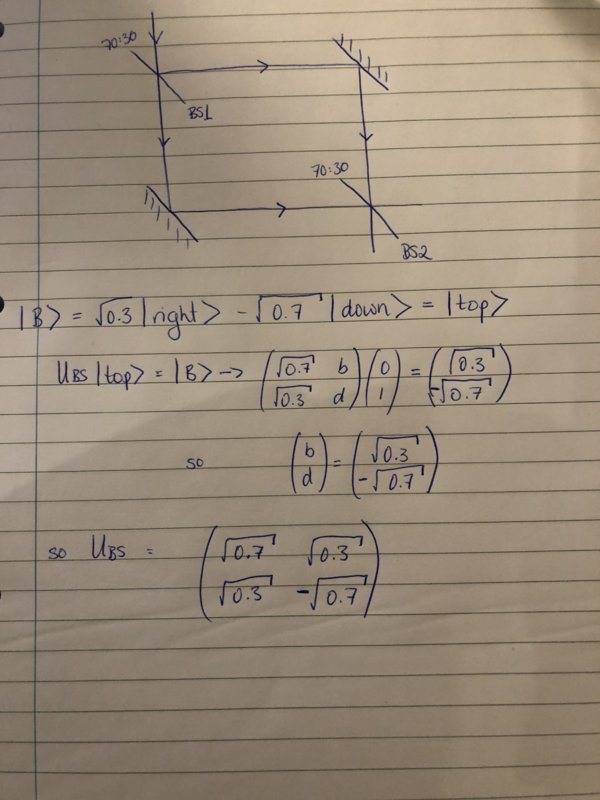

Think again about what happens at BS1 when coming in from the top.
I really don’t understand where I’m going wrong, I thought that going in from the top should be inverse of the going in from the left?
If only BS1 is present, coming in from the top, was is the probability that the outcome is right?
Ah, so something like this:
241116
Yes. You can check now that ##U_\mathrm{BS}## is unitary.
Thank you so much for your time, that was very helpful!
