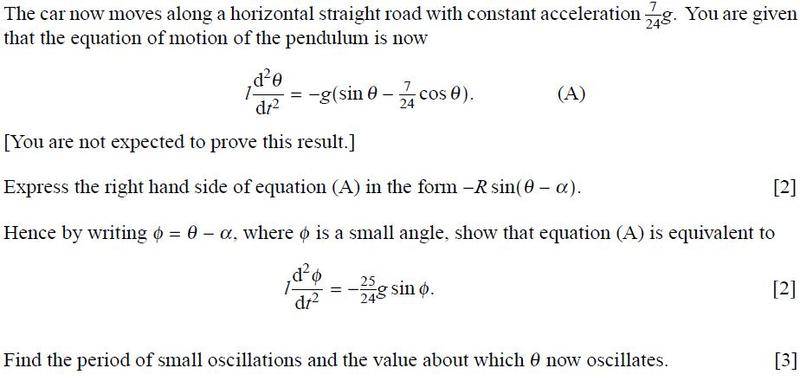

The question is uploaded.
I have completed the whole question, however, stuck on the last part.
How to find the value about which ## \rm \small \theta## now oscillates?
A source stated that ## \rm \small \alpha## is the value about which ## \rm \small \theta## is oscillating. Can anybody tell me if that is correct? If yes, then why?
What value of ##\phi## does the pendulum oscillate about?

Hint: Usually when you want to arrive at a result of the form trig(a - b) where "trig" is one of the trig functions, you are looking to employ one of the trig angle sum or difference identities in some fashion...
Apologies but I can't seem to relate your hint with my current confusion.
Start with the expression:
##g~\left( sin(θ) - 7~cos(θ) \right)##
You need to get it into a form where the sin(a - b) identity can be applied. That will mean massaging the expression until the coefficients of the existing sin(θ) and cos(θ) are the cosine and sine of some new angle, ##\alpha##.

Yes, I did all of that and also obtained the correct expression ## \rm \small -g\sin(\theta - 16.3) ##
I am just stuck at "the value at which theta oscillates"? I mean why the value of alpha is the value at which theta oscillates?

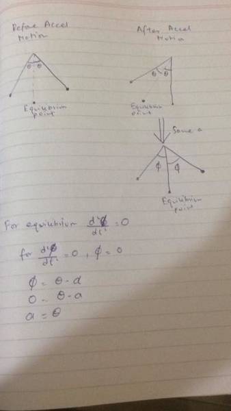

Well if the pendulum is in equilibrium and hangs in free fall, then ##\phi=0## and then ## \small \frac{d^2\phi}{dt^2}## should be equal to 0.
I get the meaning of your second question but unfortunately, I don't know the answer. Maybe ##-\alpha## because ##\theta## keeps changing.

Well if the pendulum is in equilibrium and hangs in free fall, then ##\theta=0## and then ## \small \frac{d^2\phi}{dt^2}## should be equal to 0.
Your equation is ##\ddot \phi=k\sin(\phi)##. For what value of φ will ##\ddot \phi## be zero?
## \phi = 2k\pi ## but since in this question ## \phi ## is a small angle so ## \phi = 0 ##
Right. (I see you edited your post #14 after my post #15.)
So what does that give for θ at equilibrium?
Yes it gives ##\theta = \alpha##
Ok. All done?

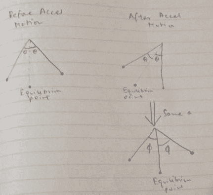

Is this explanation correct?

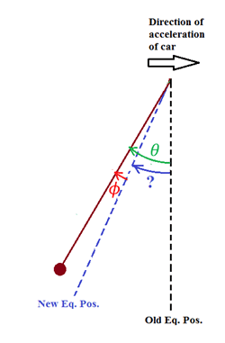

Your top right diagram indicates that ##\theta## is measured from the new equilibrium position. But, ##\theta## is defined to be the angle of the pendulum measured from the old equilibrium position (i.e., from the vertical position). ##\phi## is the angle of the pendulum as measured from the new equilibrium position.
What angle is indicated by the blue angle?
