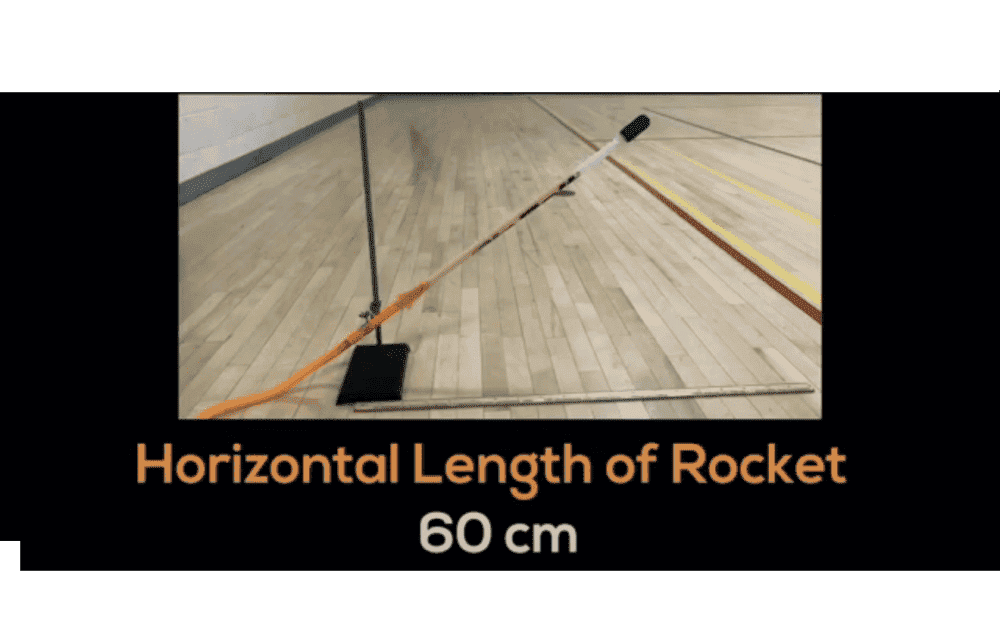

Quick question, how would I find the velocity of Projectile Motion without knowing the total distance
I'm given the object mass: 13.874g, Angle of Launch: 40˚, the horizontal length of 60cm and the time it lands on the ground: 4s. Also, gravity is obviously 9.8m/s
I don't know the distance or the horizontal velocity so I can't find any logical solution

I sense a language issue. By "horizontal length", do you mean how far the projectile moves horizontally between its launch and when it lands?
Here's is a picture of the object
Interesting. Now (as previously advised) see if you can use the given information (that 4s, for instance) to figure out the vertical component of the initial velocity.
So, not actually a rocket. That takes care of one pointless mystery. Another two or three pages and we might actually figure out what the homework problem is.
