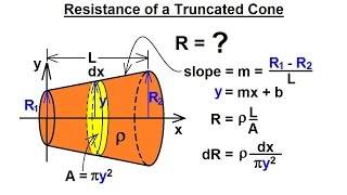

This isn't my actual homework question per se, I came upon this formula and I'm curious to know where it comes from.
R = p*h/pi*a*b and R = P*h/A
The actual homework question is about finding the voltage of a tapered wire, one where the two ends are different sizes (1cm and 2cm in this case). I've been searching for an equation to do this simply by just plugging in the values I have and I came across this.
Where
is resistivity, h is length of wire and a and b a radii of two cross sections
I've familiar with ph/A or pl/A but I've don't think I've ever seen it with Pi*a*b replace the A. I was wondering if anyone could just explain if this is in some book or it if it is derived from something else.
Thanks
##\pi a b## seems like the area of an elliptical cross section of semi-major/minor axes of a and b.
Can you be more specific regarding the origin of the expression?
Likes erobz
I don't know what that formula is for, but I think instead you are going to want to use:
$$ \int dR = \int \frac{ \rho}{A(l)} dl $$

Have you had Calculus yet? That is how this formula was derived as @erobz showed.

That works and gives the desired answer. One has to be careful to write ##A## in the denominator as a function of the linear variable ##l##.

I don't have an intuitive explanation as such but I noticed that if the taper is linear, and the resistance ##R## is of the form $$R = \frac{\rho h}{A_{eff}}$$ the effective area seems to be just the geometric mean of the end area's which in this case is;
$$A_{eff} = \left( \pi a^2 \pi b^2 \right)^{\frac{1}{2}} = \pi a b$$
It could also work for a circle of radius ##r= \sqrt{ab}## or a rectangle of sides ##\pi a## and ##b## ect. or any shape with total area ##\pi a b## so there would be an infinite number of shapes for the same area and thus the same resistance. I integrated a square taper from ##a## to ##b## and got $$R = \frac{\rho h}{a b}$$
I suspect that for any linearly tapered resistor of end area's ##A_1## and ##A_2## of the same shape, the effective area is
$$A_{eff} = \left( A_1 A_2 \right)^{\frac{1}{2}}$$

Consider rectangular end areas with side lengths ##(a,b)## and ##(b,a)##, respectively. Both will clearly have area ##A = ab##.
The linear tapering of each dimension implies that ##x = kz + a## and ##y = b - kz##, where ##k = (b - a)\ell##, ##x## and ##y## being the side lengths of the rectangular area and ##z## the coordinate along the resistor. This results in
R = \int_0^\ell \frac{\rho}{xy}\, dz = \rho \int_0^\ell \frac{dz}{(kz + a)(b - kz)}
\frac{\rho}{a+b} \int_0^\ell \left[\frac{1}{kz+a} + \frac{1}{b-kz}\right]dz
\frac{\rho}{k(a+b)} \left[\ln\left(\frac{kz + a}{b - kz}\right)\right]_0^\ell
\frac{\rho}{k(a+b)} \ln\left[\frac{b}{a} \frac{b}{a}\right]
\frac{2\rho \ell}{b^2 - a^2} \ln(b/a).
... assuming I did the integrals correctly. So the geometric mean seems to apply only if the area scaling quadratically rather than each dimension scaling linearly.

Shouldn't ##k =\large \frac{b-a}{l}##? You have ##k = (b-a)l##
Yes, that is just a typo. I used the correct expression in the rest of the post.
Oh, and as always, it is good to check your limiting cases. When ##b = a+\epsilon## we obtain to linear order in ##\epsilon##:
R = \frac{2\rho \ell}{a^2 + 2a\epsilon -a^2} \ln{1 + \epsilon/a)
= \frac{\rho \ell}{a\epsilon} \frac{\epsilon}{a} = \frac{\rho \ell}{a^2},
which at least is the correct limit.
