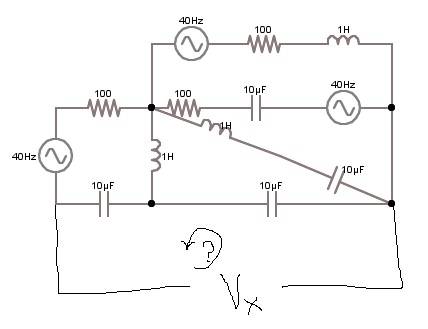

Finding the voltage in this AC circuit
In summary, the conversation discusses how to find the value of Vx in a circuit by using mesh analysis and Gaussian elimination. It is suggested to add the voltages of the two 10uF capacitors, which may not be in series topologically but are in series in the KVL sense. It is also mentioned that Vs is the voltage differential between two nodes and that finding the individual voltages at each node can also help solve for Vx.
edsoneicc
KVL at that loop
I can easily solve all the individual current and voltages in this circuit using Mesh analysis and Gaussian Elimination. But how do I get Vx? I can simply add the voltages of the two 10uF capacitors if they are in series. But they are not in series. I thought maybe if I write a KVL equation on that loop, I can solve for Vx but that equation means simply adding the voltages. I'm confused.
The two capacitors you have in mind may not be in series in the sense of the topological definition for series components, but their potentials are certainly in series in the KVL sense. So you can simply sum them as you suggest.
Vs is the voltage differential between that node on the far right and the node below the voltage source.If you can find the individual voltages at each node, you can simply subtract the node voltages. Alternatively, find the voltage drop across the two 10 uF caps at the bottom of the schematic.
