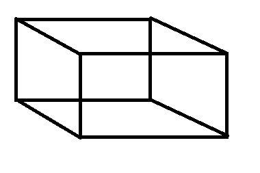

I want to find the volume of the parallepiped that has vertices the $(0,1,0), (1,1,1), (0,2,0), (3,1,2)$.
In order to find the volume we have to find three linearly independent vectors that span the parallepiped.
In order to do this, can we fix any of the given points and subtract it from the other ones?
Will the result always be the same no matter which point we choose?
How can we draw the wanted parallepiped?

It will be of the following form, right?
View attachment 5375Which could be the given vertices?
Looks good!
As I mentioned above, you just need one of the vertices to be connected to the other three along edges of the ppd, and then you should use that vertex as the common subtrahend when you do your subtractions. That'll get you three vectors along edges of the ppd.
