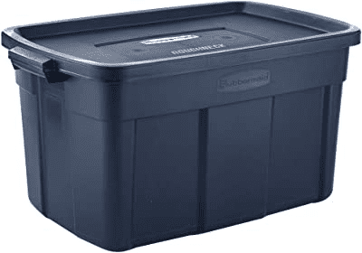

I realize a rectangle's volume is measure by multiplying length x width x height.
I have a storage tote that has a larger top than bottom. How do I figure out its volume? Is this like a 3D trapezoid?
Can I measure the volume of the rectangle assuming the top is the same as the bottom, then as if the bottom were the same as the top, then just subtract the two?
LightningInAJar said:
Homework Statement:: This isn't actually for homework. Just my own reference.
Relevant Equations:: I realize a rectangle's volume is measure by multiplying length x width x height.
I would carefully measure the inside dimensions of the tote at the bottom and top and make a drawing of the volume with those dimensions. Then I'd just add the volume of the 8 extra triangular pieces to the volume of the smaller box.
But those totes also have a slight curve to their shape, so to get a more accurate number I'd use a garden hose and a bathroom scale :smile:
How accurate do you need this volume number to be, and why?

Oh, just curious how accurate the sticker is about its volume and to compare similar bins that claim 1:2 volume differences.

To get the formula for your original question, we can integrate the delta-height times the width and length at each height.
Let ##W_b## and ##L_b## be the width and length at the bottom, and ##W_t## and ##L_t## be the width and length at the top. Let ##H## be the total height and ##h## be the height at a particular height between ##0## and ##H##.
The width at height ##h## is ##W_b+(W_t-W_b)h/H##. Likewise, the length is ##L_b+(L_t-L_b)h/H##.
So the volume of a horizontal slice of thickness ##dh## at any given height, ##h##, is ##( W_b+(W_t-W_b)h/H )( L_b+(L_t-L_b)h/H )dh##.
The volume integral is: ## \int_{0}^{H} ( W_b+(W_t-W_b)h/H )( L_b+(L_t-L_b)h/H ) \, dh ##.
We can multiply this out and group the coefficients of different powers of ##h##. (I wish I had Maple!)
Then the volume integral is ## Volume = \int_{0}^{H} ( A + (B/H) h + (C/H^2) h^2) \, dh ##.
Where
## A=W_b L_b;##
##B=(L_b(W_t-W_b)+W_b(L_t-L_b));##
##C=(W_t-W_b)(L_t-L_b)##.
##Volume = A H + B H/2 + C H/3 = (A+B/2+C/3)H##.

Are these bins similar in shape? Then it is easy.
One bin is 18gal and taller, the other is 10gal and shorter but longer. They are Sterilite brand storage bins so they aren't really for holding water, nor do I want to waste any.
I measured the first at about 16" to 18" long, 12" to 14.5" wide, and about 15" tall compensating for the lid.
The second bin I measured 20.75" long, 14.5" to 16.5" wide, and about 5.25" tall.
I calculated that the smaller bin is maybe only 90% of what it should hold assuming that the 18gal one does in fact hold that much. I think tomorrow I might cheat and draw these shapes out using Sketchup and use the volume tool since the tops and bottoms are slightly different sizes.
Using the equations of post #6, I get that this is 3385 cubic inches.
This is 1688 cubic inches.
The ratio is 1:2.
Water is 231 cubic inches per U.S. liquid gallon. 3385 would be 14.7 gallons and 1688 would be 7.3 gallons.
