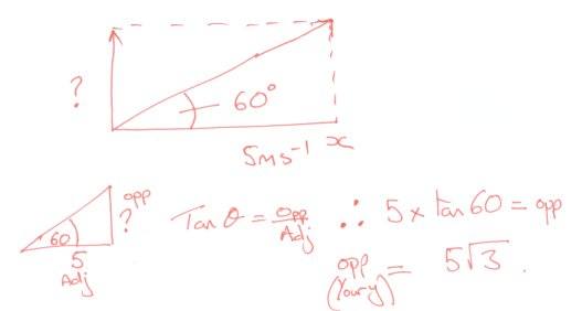

How exactly do I find the y-component for this problem?
I originally drew a diagram of a triangle and came up with the equation cos 60=x/5, when I tried to solve for x I got 2.5 m/s. This isn't one of the solutions available so I am thinking I'm not using the correct equation.
cos 60 should be equal to the vector adjacent to the 60 degree angle divided by the hypotenuse. You're looking for the vector opposite from the angle, so there's a different operation for that.

i would start out with a diagram, showing the angle and x and y velocities.
it makes the trig much easier
Hi,
as your not given the hypotenuse your are only given an angle and the x component you need to use the tangent function
SOH CAH TOA
This then becomes 5 * Tan(60) = the y component you are after.
I hope that helps and more importantly I hope I am right
thanks
Mr C
