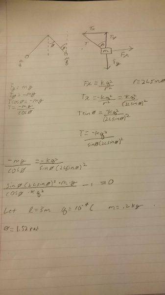

Two spheres are suspended on strings and repel each other. Using the graphing function of your calculator setup and solve a formula to find theta.
The length of the rope is 3.0m, q = 1.0e4 and m = .2 kg.
F=k*q1*q2/r^2
Using Newton's second law I've tried several times to set up the formula to solve for theta but I am unable.
I know that the y component of tensions is equal to the force of gravity. Also that the X component of tension is equal to force caused by the repulsion of the two charges.
Equations look OK to me. Perhaps the instruction means they want you to solve numerically, not analytically ?
We were told to find the equation, set it equal to zero and plug in our given mass, charge and length then find the x intercept with a graphing calucator. I get 60 degrees which is about twice what it should be.

Perhaps you can use this thread to check if your calculator works properly
(Although I admit that for the numbers at the bottom of your sheet ##\pi/3## fits a lot better than ##\pi/6## :) )
Oops, that's what I get for being in a rush. The length of the rope is 3.0m, q = 1.0e4 and m = .2 kg.
Hefty charge !
Oh jeeze I just cannot type tonight. q = 1.0e-4
Well, as I said,
So I'm at a loss. How do you know that it's not right ?
(can always try the check with this other thread to see if that fits...)
My professor said that the angle should be about 30 degrees. It's possible I misheard though. I can't find an error so I think that might be the case.
