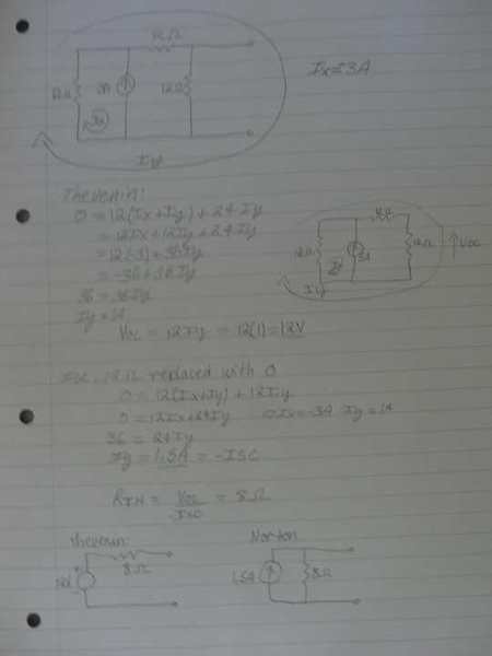

Finding the Thevenin and Norton equivalent circuit
Just wondering whether i have done it right?
So the Thevenin circuit has a voltage supply of 12V, in series with an 8 Ohm resistor, while the Norton circuit has a current supply of 1.5A in parallel with an 8 Ohm resister.
Ok my tutor just said that it's right...however since I'm a very paranoid person, i'd like a second opinion, just to reaffirm :)
It's difficult for me to determine if you have done it correctly without seeing your calculations and circuit diagram. However, the general approach for finding the Thevenin and Norton equivalent circuits is correct. You need to simplify the original circuit to a single voltage source and a single resistor for Thevenin, and a single current source and a single resistor for Norton. Make sure to double check your calculations and make sure they follow the correct equations for Thevenin and Norton equivalent circuits. Additionally, it may be helpful to create a circuit diagram for the equivalent circuits to visually check if they are correct.
