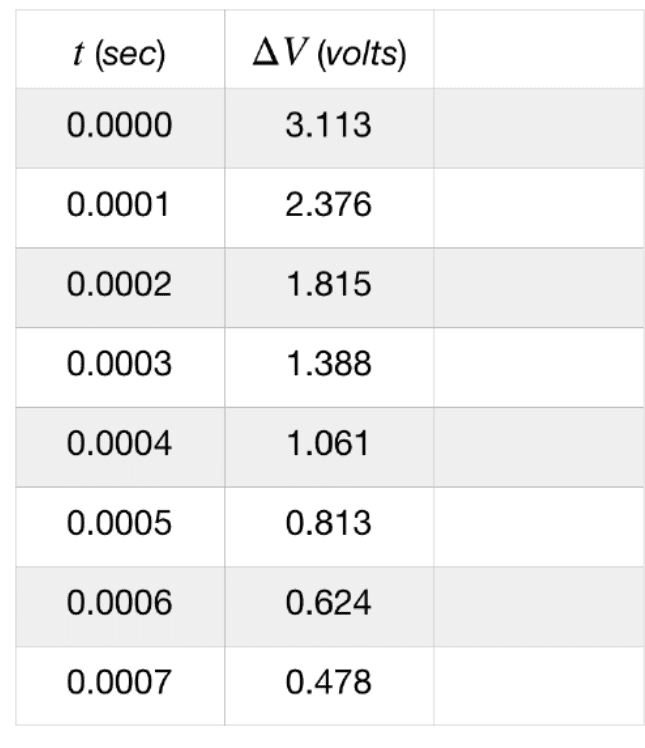

- Fill-in the third column of the table with appropriate calculated values which result in a graph vs.
time that we expect to be a straight line.
- Make a plot of your computed third column numbers vs. time, and insert a best-fit line.
- Use the best-fit line to extract the time constant of the circuit.

$$R = 295.3 \Omega$$
$$I_0 = 0.01765 A$$

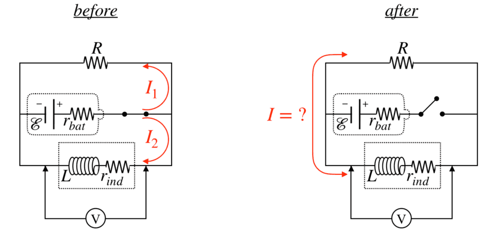

Edit: Picture of the Circuit (Simple RL circuit)
The value of L is not given.

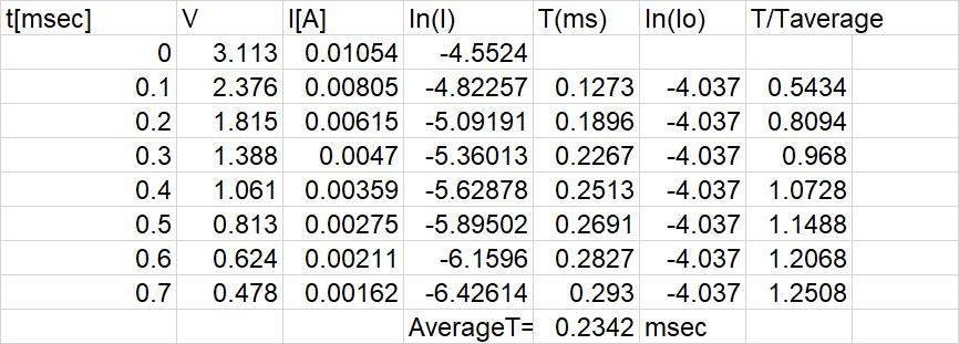

I=V/R ;I=Io*e^(-t/T); ln(I)=ln(Io)-t/T
-t/T=ln(I)-ln(Io)
T=t/((ln(Io)-ln(I))
However, the "constant" T is not so constant. See the attached no.1
That means something is wrong.

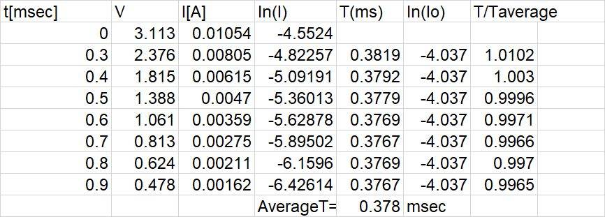

If we shall change the time t [let's to add a 0.2 msec in all position] then the error will be 1% from average. See attached no.2
