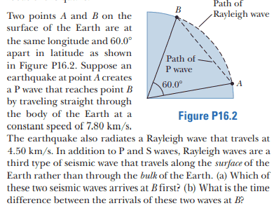

Finding time difference between two arriving wave fronts
In summary, the conversation discusses the formula AB=2Rsin30° and its derivation. It is shown that this formula is derived from drawing a perpendicular line from the center to the base AB and splitting it into two equal parts. The conversation also touches upon the dimensionality of angles and the concept of assigning a dimension to them, with some resources provided for further reading.
member 731016
Please see below
S = Rθ

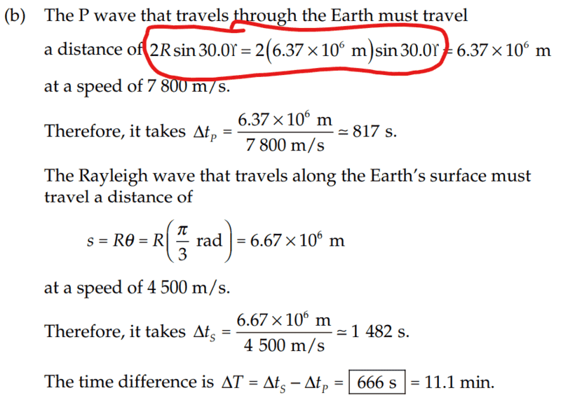

For part(b),
The solution is,
However, where did they get the formula shown in red from?
Many thanks!

##AB=2R\sin30^o.## Do you see why? Hint: Draw a perpendicular from the center to the base AB. It splits AB into two equal parts. What is the length of each part?
Likes member 731016
Thanks I see it now @kuruman ! Is the reason why they used radians instead of degrees in the arc length formula is because radians is a ratio of the length while degrees is not.
Many thanks!
What you call the arc length formula is actually the definition of the angle as the ratio of the arc length to the radius. As such it has no dimensions.
Likes member 731016
