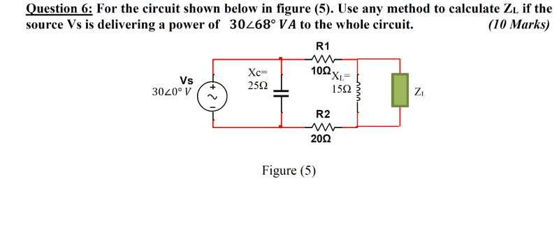

In summary, this is a question from a past final exam for my Electrical Circuits course. I've spent a good few hours trying to solve it but haven't really had much luck. Any method can be used I figured if I found the voltage of the known XL, it would be equivalent to the voltage of the unknown ZL (using thevenin) but then I'm missing the current, in which if I used the general form, I don't have the resistance for ZL. which leaves finding the Zt from the power and then finding the ZL by back tracking it but the unknown resistance is parallel with the XL so I'm finding it impossible to do it algebraically. Also tried to use the power (
Ravensight
Thread moved from the technical forums, so no Homework Template is shown
So this is a "bonus" question from a past final exam for my Electrical Circuits course. I've spent a good few hours trying to solve it but haven't really had much luck. Any method can be used I figured if I found the voltage of the known XL, it would be equivalent to the voltage of the unknown ZL (using thevenin) but then I'm missing the current, in which if I used the general form, I don't have the resistance for ZL. which leaves finding the Zt from the power and then finding the ZL by back tracking it but the unknown resistance is parallel with the XL so I'm finding it impossible to do it algebraically.
Also tried to use the power (i'm guessing apparent power since it's mentioned in VA) to find the I conjucate, and I, and Zt for the circuit but still, no luck.
Attached is the question I have in mind. I still have 10~ days left for the final but I rather know how to solve it as soon as possible and get it out of the way.
Any help would be appreciated!

Suggestion is to characterize the inductor and 15 ohm resistor as a parallel combination: ## 1/Z=1/(15 \Omega)+1/(j \omega L) ## . The problem is ultimately to find ## \omega L ##, but work through the algebra. It should be straightforward. Meanwhile ## X_c=25 \, \Omega ## ==>> ## Z_c=-j/(\omega C) ##, so that ## Z_c=-j \, 25 \, \Omega ## is a more accurate description.

It looks as if 15 Ohms refers to an inductor and ZL means an unknown load impedance.

1) Use a phasor diagram to start with. It looks as if the generator sees an impedance in the First Quadrant, which is inductive. The generator gives 30 volts at 1 Amp at an angle of 68 degrees, inductive, lagging.
The total circuit has a shunt X drawing 1 x sin 68 = 0.93A. However, the 25 Ohm capacitor draws 1.2A, so the rest of the circuit draws 1.2 - 0.93 = 0.27A inductive, which is 30/0.27 = 111 Ohms inductive.
The total circuit has an equiv shunt R drawing 1 x cos 68 = 0.37A, a shunt R of 30/0.37 = 81 Ohms. Allowing for the two resistors, the inductor and ZL must together present an equiv series (AC) resistance of 81 - 10 - 20 = 51 Ohms.
2) To recap, looking into the circuit to the right of the resistors, we see a resistance of 51 Ohms in series with an inductance of 111 Ohms. Now we must find the equivalent shunt values.
(i) Find Q = 111/51 = 2.18
(ii) Rp = (Q^2 + 1 ) x Rs = (4.73 +1) x 51 = 292 Ohms (this is the shunt equiv resistance of the load)
(iii) Xp = Rs / Q = 134 Ohms inductive (this is the reactance of the load in parallel with the 15 Ohm inductor).
3) Find shunt reactance of ZL alone (not with 15 Ohm inductor).
The reactance of ZL in parallel with the 15 Ohm inductor gives an inductive reactance of 134 Ohms. So the reactance of ZL is capacitive.
1/134 = 1/15 - 1/Xload
Xp load = 16.9 Ohms capacitive
4) The impedance of the load is therefore 292 Ohms in parallel with a capacitive reactance of 16.9 Ohms.
Convert to series form.
(i) Find Q = 292/16.9 = 17.3
(ii) Rs = Rp /(Q^2 + 1) = 292 / (17.3^2 +1) = 0.97 Ohm
(iii) Xs = Rs x Q = 0.97 x 17.3 = 16.8 Ohms
Answer: ZL = 0.97 - j16.8

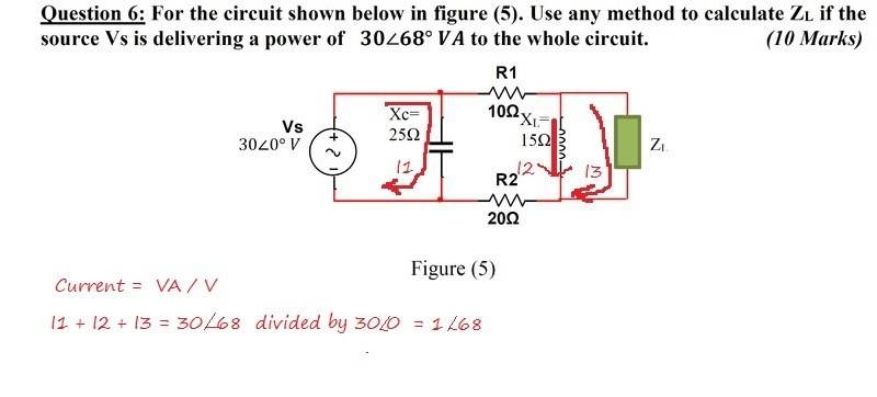

I1 = 30∠0 volts / 25∠-90 ohms = 1.25 ∠+90 amps
I2 + I3 = (1∠68 - 1.25∠+90) amps , change into rectangular and calculate
KVL
volts across XL and ZL = (30∠0volts - (I2 + I3)amps X 30∠0 ohms) volts
so I2 is (that voltage / 15∠+90 ohms) amps
and I3 is readily found by KCL
back to Ohm
ZL = ( (30∠0volts - (I2 + I3) amps X 30∠0 ohms ) volts / I3 amps ) ohms
............^^^^ that's R1 + R2...
lots of polar ↔ rectangular but that'd be fun.Check my thinking ?

Not sure I follow with either responses, as the VA (S phasor) gives the current conjugate, in which the angle for the actual current is the opposite? I tried finding ZL using thevenin (Zth) circuit and then using the S (VA) to get the total impedance from the current (S= I^2non phasor * Z phasor) and then reduced the Zt-Zth in the thevinin circuit (series) to get ZL.
where Is = 1∠-68
Ztotal = 30∠136 (30∠68/1∠-68)
Zth = 26.52∠-45 from ((10∠0+15∠90+20∠0)//25∠-90)
therefore, series circuit from thevenin
ZL= 30∠136-26.52∠-45 = 56.517∠135.5 ohms?you can use your calculator to subtract and add complex numbers (impedances) in polar form as they are, with the ∠. Which is what we were taught in my university. Makes it much easier and faster to solve these problems.

If Ztot=Vs^2/S* total impedance seen from Vs[source]
[Since S=Vs*I*[I conjugate] then I=S*/Vs and Ztot=Vs/I=Vs^2/S*[conjugate S].
Ztot=30^2/(30*(cos(68)-sin(68)i))=11.238+27.81i
On the other hand Ztot=Zeq*Xc/(Zeq+Xc) where Zeq=ZL*XL/(ZL+XL)+R1+R2
From Ztot equation Zeq=Ztot*Xc/(Xc-Ztot)
Zeq=(11.238+27.81i)*(-25i)/(-25i-11.238+27.81i)=2.409+13.68i
From Zeq equation [Zeq=ZL*XL/(ZL+XL)+R1+R2] :
ZL=[(R1+R2)*XL-Zeq*XL]/[(Zeq-XL-(R1+R2)]
ZL=[(10+20)*15i-(2.409+13.68i)*15i]/[(2.409+13.68i-15i-(10+20)]
ZL=-8.137-14.61i

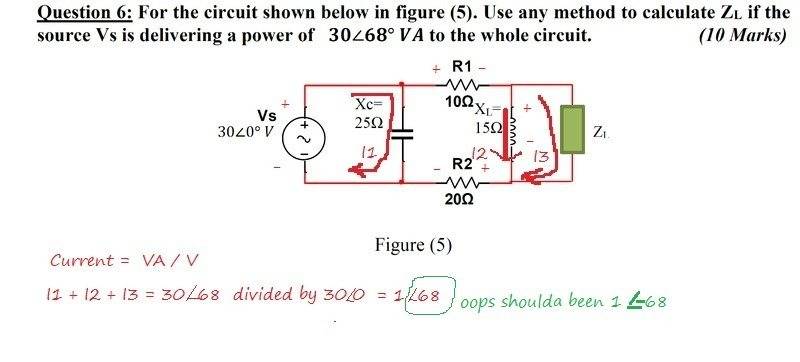

This picture made sense to me before Babadaq made me aware of the IEEE definition that swaps sign of θ
With that big capacitor hanging right across the supply an angle of +68 (leading) made intuitive sense
Instead, my current I1 +I2 +I3 should be 1∠-68 , lagging
Now, 1∠-68 in rectangular is 0.37 - j0.93
and current I1 through the 25 Ω capacitor should be V/Xc= 30/-j25 = +j1.25
Subtracting I1 of +j1.25 from sum (I1 + I2 + I3) yields (0.37 - j0.93) -j1.25 = 0.37 - j 2.18 = 2.21 ∠-80.37
meaning 2.21 amps at angle -80.37 must flow through the 30 ohm sum of R1 and R2.
That would produce 66.3 volts at angle -80.37, 22.1 of them across R1 and the other 44.2 across R2..
So let's assign some polarity signs and write KVL:
I'll start in lower left corner and walk clockwise :
-Vs + (I2 + I3) X R1 +(Volts across paralleled Zl and j15Ω) + (I2 + I3) X R2 = 0(Volts across paralleled ZL and j15Ω) = Vs - (I2 + I3) X (R1 + R2)
(Volts across paralleled ZL and j15) = 30∠0 - (66.3∠-80.37) = 30 - ( 11.09 -j65.37) = 18.91 +j65.37 = 68.05∠+73.9
Now we can calculate I2. It's (Volts across paralleled ZLand j15Ω) / j15Ω = 68.05∠+73.9 / 15∠+90 = 4.537 ∠-16.1 = 4.36 -j1/26
hmmmm I2 = 4.36 -j1.26
Now we can calculate I3
I3 = Itotal - I1 - I2
I3 = (0.37 -j0.93) - j1.25 - (4.36 -j1.26) = -3.99 -j0.92 = 4.09∠-167
so ZL must be Volts across itself divided by current through itself I3
which is (68.05∠+73.9) / ( 4.09∠-167) = 16.64∠240.9 = -8.09 -j14.54

tech99 said:
ZL=-8.137-14.61i
How can the resistance be negative?[/QUOTE]
My real component differs from Babadaq's by roughly four parts in 811, ~½%
and my imaginary by roughly seven parts in 1457, about ten times less oops make that also ~½% (i said i was pooped)
@Babadag 's skill with math i revere
so I am very pleased with the small difference that resulted from our diverse methods, especially considering how much rounding i did in polar ↔ rectangular conversions.

That the solution to the problem as given requires an active load(negative resistance) makes me question - was that author's intent?
It's late and I'm pooped and I'm not going to work it again right now with assumption author didn't follow IEEE definition for VA and total current is leading not lagging.
IF anybody has this one in a spreadsheet - a question---
When you assume total load is leading not lagging , as it looks to me like it should be with a big capacitor separated from rest of load by resistors,
Do you get a passive load ie one whose real term is positive?

Starting from the impedance seen by Vs and working to the right, removing parallel and series components as we go, Zl is the final result:
Perhaps the problem originator didn't use the IEEE convention for complex power as VI*; maybe they just used VI. An active load seems a little far-fetched for a problem like this.
