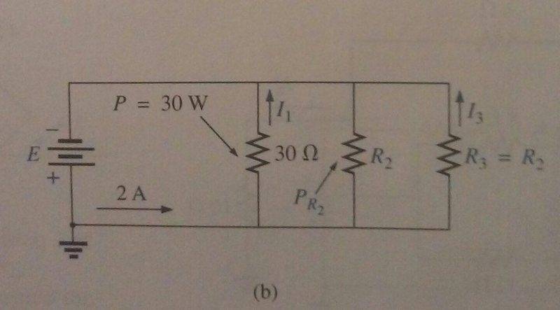

See attached photo
Kirchhoff's current law[/B]
So, I was solving for I3 and got the correct answer, but I want to be sure that I arrived at the right answer by using a reliable thought process. I don't want to get lucky!
So, I had already determied I1 and got 1A.
With that information I thought... It starts out with 2 A, and there are 2 identical resistors (R2 and R3). I3 = 1 A, so these 2 resistors must each have a current of .5 A going through it. From that I found that I3 = .5A
Is this a reliable thought process? What are some other ways to view this problem?
Thanks!
Your method is correct. I believe it is the only way to solve this problem.
Any solution is going to rely on Ohm's and Kirchoff's Laws.
But you could use the fact that R1 is dissipating 30W to find ##\left(\sf using~\color{blue}{power﹦\frac{E^2}R}\right)## that E=30V
Then, with the battery delivering 30×2=60W, this means the R2 R3 combination is dissipating 30W. So R2##\|##R3 must be 30Ω, and so on ...
