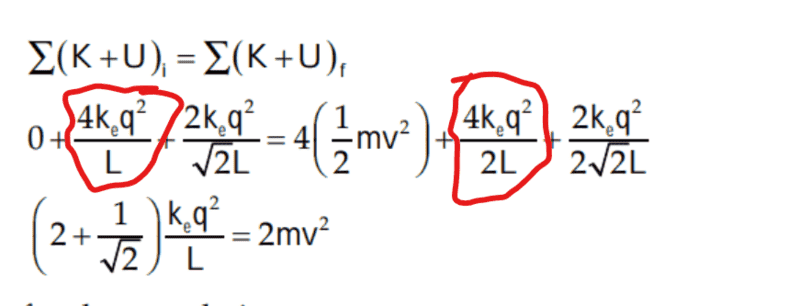

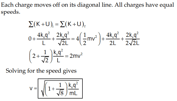

Four identical particles, each having charge ##q## and mass ##m##,
are released from rest at the vertices of a square of side ##L##.
How fast is each particle moving when their distance from
the center of the square doubles?
##U_E = qV ##
##KE = \frac{mv^2}{2} ##
I tried solving the problem above by using conservation of energy
##U_{Ei} = U_{Ef} + KE ##
##\frac{4k_eq^2}{\sqrt{2}L} = \frac{4k_eq^2}{2\sqrt{2}L} + 4(\frac{mv^2}{2}) ##
##\frac{2k_eq^2}{\sqrt{2}L} = 2mv^2 ##
## v = \sqrt {\frac {k_eq^2}{\sqrt{2}Lm}} ##
However, the solutions solved the problem differently
Would anybody please tell me what I have done wrong?
Many thanks!
You have not calculated the potential energy correctly. The diagonal distance is longer
Likes member 731016

Thank you for your replies @malawi_glenn and @PeroK ! The electric potential at the upper left corner is
## V = k_e(\frac {q}{L} +\frac {q}{L} +\frac{q}{\sqrt 2L}) ##
Where the electric potential energy is
## U_{ei} =k_e(\frac{q^2}{L} +\frac{q^2}{L} +\frac{q^2}{\sqrt 2L}) ##
## U_{ei} =k_e(\frac{2q^2}{L}+\frac{q^2}{\sqrt 2L}) ##
Many thanks!
This is not all the potential energy of the system. You understand this, right?
Likes member 731016

Not quite.
The EPE of two charges is a joint property. It is the energy change if one particle were to go off to infinity. Once one has gone, there is no energy change if the other does likewise.
Think how that works with more than two.
Likes member 731016
... a useful trick is to think of an external force holding each charge in place once it has reached its final point in the configuration. This force does no work, so does not affect the PE of the system. Only the force that brings the next charge in from infinity does work.
That's the way I think about it. In fact, I learned that from @ehild several years ago.
Likes member 731016 and SammyS
Or you can count the energy of each pair of charges in the system. Here you have 4 charges so there are 6 distinct pairs. Four of them have the side of the square as distance and two the diagonal. If you multiply the energy obtained in post 6 by four you double count the pairs.
Likes member 731016

Your problem here is simple counting. If we have four charges A, B, C and D, then there are six pairs of interactions: AB, AC, AD, BC, BD, CD.
This gives us six terms to add together.
If there were five charges, then we would have ten pairs of interactions. Etc.
Likes member 731016

First consider one pair, the upper left corner charge and the lower right corner charge.
First, they are separated by ##\sqrt{2}L## and are hold at rest, later they are separated by ##2\sqrt{2}L## and have speeds ##v##.
When you have figured this out, then you can generilize this to the given problem.

1) You use the principle of superposition, which allows you to add potentials.
2) You calculate the potential relating to each charge already in place.
Likes member 731016
