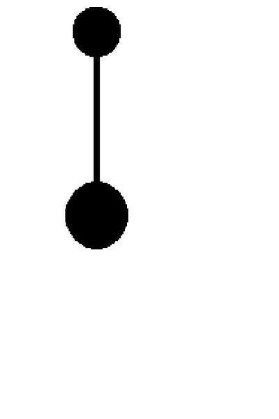

from looking at the problem, i think it's safe to model the top mass as a point since it is fixed, but the bottom has to be spherical, that's the whole trick to it. I'm attaching a diagram for those visual learners. i know (at least i think if I remember right) the center of mass is:
cm of l=.5l (1kg)
cm of M(big mass at bottom) we'll say is at 0 and is 2kg
cm of m (little mass at top) is l and is 1kg
so the cm for the system is:
[(0*2)+(.5l*1)+(l*1)]/(4kg)= .375l
so that the cm of the system is 3/8 of the way up the length of the rod. am i good so far?

am i on track with that cm? and I'm not quite sure how to combine the moments of inertia of the different objects
Sure. Given your assumptions (spheres centered at y=0 and y=L; stick centered at L/2), your center of mass calculation is good.
To calculate the moment of inertia, you'll need to go a step further in assumptions. How big is the bottom sphere compared to the stick? For example: If the sphere has radius L/2, then the stick is only an L/2 long projection from the sphere. Treat the system as a set of three non-overlapping objects, find the rotational inertia of each object about the cm of the system and add them up.
(I hope you agreed upon a complete description of the problem before you accepted the challenge!)
so that the total moment of inertia is 2/5*2*R(radius of large mass)^2 +2/5*1*r(radius of small mass)^2, + 1/12*1*L^2=
4/5R^2+2/5r^2+1/12L^2?
then assuming the top and bottom masses have the same density, the volume of the top is half the volume of the bottom so that the radius of the larger object is 2^(1/3) times the radius of the larger object so that
R=r*2^(1.3) and the total equation becomes:
4/5r^(2/3)+2/5r^2+1/12L^2
does that seem right? did it get me closer?
Those are the moments of inertia of each piece about its own center of mass.
So you can't just add them. Use the parallel axis theorem to find the moment of inertia of each object about the cm of the entire system. Add those up and you'll have a meaningful moment of inertia for the system.
Also: If the stick is L long, do you mean for the complete object to have an overall length of: 2R + L + 2r ?

that last part abotu the length is correct. i don't remember ever hearing anythign about the parallel axis problem before. Well, it's possible i learned it as a different name. can you please enlighten me?
edit: just looked it up on wikipedia but I definitely don't understand the explanation there. it says
Iz=Icm+Md^2
I'm trying to solve for ICM so i want Iz-Md^2 but that just confuses me
now that I'm thinking, i hope i explained the problem right from the beginning. the rod isn't rotating about itself, ir's simply on a surface, say a desk and allowed to plop over to horizontal. does all this adding the moments of inertia still apply?
Yes it applies. The system will rotate as it falls, so some of the kinetic energy will be associated with the angular motion.

Here's a useful discussion of the http://hyperphysics.phy-astr.gsu.edu/hbase/parax.html#pax". Briefly, if you know the moment of inertia of an object about an axis through its center of mass, the parallel axis theorem allows you to calculate its moment of inertia about any parallel axis. For example: You know that the moment of inertia of a stick about its center is 1/12 M L^2. You can use the parallel axis theorem to find its moment of inertia about the end:
[tex] 1/12 M L^2 + M D^2 = 1/12 M L^2 + M (L/2)^2 = 1/3 M L^2[/tex]
No, you have Icm and need Iz.
In your case you have the moments of inertia of each piece about its own center of mass. So you can use the theorem to compute the moments of inertia about the center of mass of the entire system.

It will be easier to get the final result if you assume the two end masses have different densities and the same radius. Assuming the lower ball stays in contact with the floor the whole time, when the top ball hits the floor the rod will be horizontal. Otherwise you have to figure out what the angle is in terms of R and L.
yes looking at it, that's what I'm going to do i think. this afternoon is crunch time for me to get down to it or i owe him lunch on friday. oh well, I'm still ahead in total since I usually get him with bio puzzles
