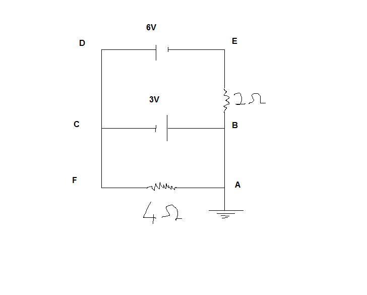

What is the voltage at D ? What is the the potential difference between B and E?
The point D is connected to +6V and -3 V . So the effecting voltage at D is 3 V.
But the answer is -3 V.
For calculating the potential difference, I found out currents in all branches using KLR and JR.
Is there any shorter method without finding out the currents?

Pay careful attention to the polarities of the batteries.
If you "walk" the loop from B to C to D to E, what's the change in potential?
From B to C, there is Vc - Vb = -3V and Ve-Vc=-6V (is it right?)
adding them Ve-Vb = -9V
so Vb-Ve = 9V
That answers my second question.
What about the first?

You passed by the answer when you "walked" from B to D! :smile:
"Walk" the loop from A to B to C to D.
I got it now.
Thanks!
