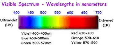

Simon Bridge said:
Please show your reasoning.
An electron can only absorb decrite (quantized) energies of a photon.
E2 − E1 = E ⇒ 70.5 nm
After using f = E/h, then λ = c/f.
Or λ = c/(E/h) = c*h/ΔE = 70.5 nm.
Since this is the highest wavelength that can be absorbed by the electron, and visible light is a higher frequency (a minimum of 400 nm), no colors are absorbed.

OK, so are there any visible wavelengths?
700ish = Dark red.
All right. Any more?

ΔE2-1 = 2.82087e-19
ΔE3-2 = 4.70146e-19
ΔE4-3 = 6.58204e-19
h = m2-kg/s
6.626e-34
λ = c*h/ΔE
ΔE2-1 ⇒ λ2-1 = 705 nm (dark red)
ΔE3-2 ⇒ λ3-2 = 423 nm (purple)
ΔE4-3 ⇒ λ4-3 = 302 nm (UV ~ not visible light)
