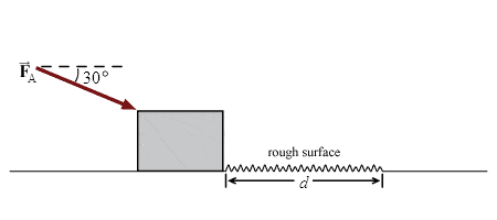

In summary, a box with a mass of 59.0 kg is pushed a distance of 83.0 m across a rough warehouse floor by an applied force of 204 N at an angle of 30.0° below the horizontal. The coefficient of kinetic friction is 0.100. To determine the work done by the force of friction, the equations W = fdcosΘ and Fƒ=μN were used. However, it was found that the normal force is larger than the weight, causing the vertical component of the applied force to add to the weight. This results in the wrong answer and further calculations are needed.

A box of mass
m = 59.0 kg
(initially at rest) is pushed a distance
d = 83.0 m
FA = 204 N
directed at an angle of 30.0° below the horizontal. The coefficient of kinetic friction between the floor and the box is 0.100. Determine the work done by the force of friction
W = fdcosΘ
Fƒ=μN
I used the two above equations and I found that the applied force of friction would be 57.82 because that is .1*59*9.8 and then if you put that into the first equation, the work would be 57.82*83*cos30 which equals 4156.108 and then since it is opposite the applied force, it would be -4156.108. At least I thought. That's wrong and I don't know why. Please help!
But in this problem, the normal force is larger than the weight.
Likes SammyS
The vertical component of F add to weight.
Remember when resolving vector, here force, noted all the components. Here the X and Y components.
