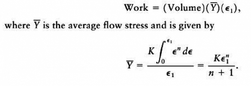

The problem is asking to find the change in temperature of forged cylinder. I know how to calculate this,
, however I am struggling to find the work done on the cylinder, which is required to solve this problem. The cylinder is annealed copper, which is compressed from a height on 2in to 0.6in. I was able to find the forging forces (attached below in excel screen shot), and they are correct. I am given the density: 0.37336lb/in^3, and the specific heat: 861in-lb/lb°F, now I just need to find the work done on the cylinder.

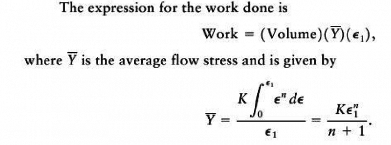

When the coefficient of friction is 0, the work is easy to find,
However once the coefficient of kinetic friction is non-zero, this equation no longer applies.
I tried finding the area under the curve by plotting in excel and extracting the equation, however the values I am getting are not even close, I'm pretty sure I'm making some conceptual mistake, any help is much appreciated.
Figured it out, bounds were incorrect. X axis was in terms of percentage increase, not actual increase.
