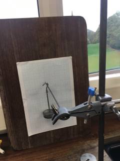

I have a question regarding finding the Young’s modulus of a rod by loading a weight to the end and measuring the change in displacement.
The experiment is part of my advanced higher physics project on Young’s modulus however it is the only experiment that I’m doing that the book “Tyler” does not cover, and so I am slightly confused as to how I actually derive the relationship through this method.
I know it isn’t a great set up but it’s all I can do with the equipment I have.
So my question is how do I calculate it via this method?
Thanks

Not with the set up shown though . The holding system needs to be much more rigid and the rod needs to be set horizontal .There also needs to be a more accurate deflection measurement method employed .
If you have some freedom to design this experiment properly then I suggest that you use a much longer thin rectangular strip as the test object . Clamp one end of this tightly to the edge of a solid bench and - if nothing better is available - use a metre rule to measure the deflection . The rule being held in a retort stand sitting on the floor . The much larger deflection for given loads and the improved rigidity of the set up should allow you to get better results and a reasonably accurate value for Young's modulus .

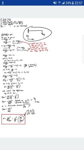

Is this the correct derivation?
The image is too blurry to read it. But if you begun with the initial equation and ended up with the last one, chances are you are correct.
