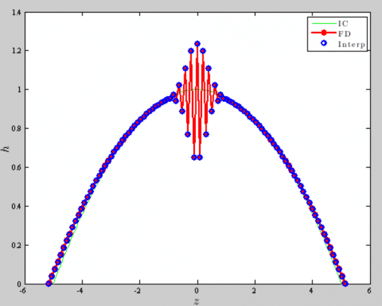

hi PF! I've attached pictures to help you all see what is happening. Basically, I am running a forward time-centered space finite difference scheme, which is $${h_i^{j+1} \approx \left[ h_i^j \left( \frac{h_{i+1}^j-2h_i^j+h_{i-1}^j}{\Delta z^2} \right) + \frac{1}{2}\left( \frac{h_{i+1}^{j}-h_{i-1}^j}{ \Delta z} \right)^2 \right]\Delta t+h_i^j}.$$ The system runs fine as long as my final run time ##tf## is low. Since ##\Delta t## is defined as ##tf/M^2## where ##M## is the number of spatial nodes (determined by scaling, which I know is accurate).
At any rate, the following pictures are from the same number of time iterations, but different the divergent picture has a much larger ##tf## value. Any idea why one diverges and the other maintains equilibrium? I know ##tf## is the reason, but why?
Thanks so much!
so you increase your time step when your total run time tf increases? That doesn't sound right, as most numerical methods for such PDE's have a CFL stability criterion of the form [itex]\frac{\Delta t}{\Delta x} < C[/itex]
You can do a von Neumann analysis for your convection-diffusion problem and check the necessary and sufficient condition for stability:

if I make the spatial domain bigger, all else equal, my ##\Delta z## get's larger, so why would this be any different with time?

It looks like your trying to model an equation of the form:
[itex]\frac{\partial h}{\partial t}-\frac{1}{2}\frac{\partial h}{\partial z}\frac{\partial h}{\partial z}=+h\frac{\partial^2 h}{\partial z^2}[/itex]
This looks like an ugly nonlinear form of the advection-diffusion equation:
[itex]\frac{\partial h}{\partial t}+c\frac{\partial h}{\partial z}=\alpha\frac{\partial^2 h}{\partial z^2}[/itex]
Where [itex] c [/itex] is a flow velocity and [itex]\alpha [/itex] is a diffusivity of some sort. Using a explicit finite difference scheme to advance the linear advection diffusion equation, Von Neuman analysis shows that numerical stability requires [itex]\delta t <\frac{2\alpha}{c^2} [/itex] and [itex]\delta t <\frac{\delta z^2}{2\alpha} [/itex].
The analysis of the nonlinear problem is tricky, but we can come up with crude conditions for stability by recognizing that [itex] c \sim -\frac{1}{2}\frac{\partial h}{\partial z}[/itex] and [itex] \alpha \sim h[/itex]. Using these with the above stability condition we get that
[itex] \delta t < \frac{\delta z^2}{2h_{max}}[/itex].
Again this is only a crude analysis. If you use a time step larger than the one I suggest, then it's pretty likely that you will get a numerical instability. However, using a time-step smaller than what is derived does not guarantee stability.

the_wolfman, I'm just learning about finite difference techniques, but I think von Neumann is only valid for linear problems since it implies a solution has separated variables. I have read, however, about linearizing the PDE and then applying von Neumann analysis. Does this sound right to you, or anyone?
And Chet, of course the PDE you proposed is the correct one I'm dealing with, and your calculus trick give an impressive result! I didn't re-write it because I simply didn't see it. So if I were to discretize the problem you have posed would I get something like this
$$ \frac{y_i^{j+1}-y_i^j}{\Delta t} = \frac{2}{3}\frac{(y_{i+1}^j)^{3/2} - 2 (y_i^j)^{3/2} + (y^j_{i-1})^{3/2}}{\Delta y ^2}.$$
But this elegant rewritten form remains non-linear. Would you advise me, when checking for stability, to linearize it (which I've never done but am reading about it) and the use von Neumann or do you have something else up your sleeve?
Thank you both so much!
It is Friday afternoon and my brain is not fully functional, so forgive me if I'm wrong. But I think Chet's approximation of your PDE is off by a coefficent. He has a factor 2 when I think it should be a half. I bring this up because this factor matters in converting the RHS of the equation into a total derrivative. Either way it's worth double checking.
Your right in that you often cannot apply von Neumann to nonlinear equations. One way to get a stability condition is to linearize the equations. However this will not guarantee stability. It we give you a rule of thumb. In using the result from the advection diffusion equation I kind of did this, but I miss the effect of two terms(?). My result does show why the stability should depend on both the time step and grid spacing.
If you do a more formal linearization I'd be curious as to what stability conditions you get.

First, why don't you try it to see if it works any better than the original scheme. I can think of lots of ways of improving the stability if you are not then happy.
Of course, the obvious stability parameter is ##\frac{Δt}{(Δx)^2}##, but that's also going to depend on the entire profile at a given time.

I ran the y scheme you presented, and the results were bad. The issue is I think in the initial condition, which is in green above. Since values are less then 1 and lifted to a power greater than 1, they are all being dwarfed very small. As a result of just a few time loops I'm getting y values pretty much all zeros. Any ideas why?
But I am getting the original scheme I posted to run with larger values of ##tf## by heuristically changing the number of time loops by factor's of 10 without changing the number of spatial nodes. I'm mainly curious as to why increasing the time loops allows higher values of ##tf## to work. Any ideas or direction? Again, ##dt :=tf/M^2## where ##M^2## is the number of time iterations and ##M## is the number of spatial nodes.
