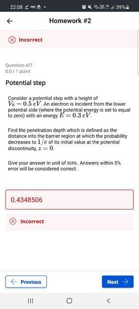

In summary, the autograder says that my answer of 0.434nm is incorrect because I have substituted values given E and Vo and mass of electron and hket in the above formula for penetration depth in case of finite potential well. The formula is independent of probability or probability amplitude, and the autograder says that my answer of 0.434nm is incorrect. I have just substituted values given E and Vo and mass of electron and hket in the above formula for penetration depth in case of finite potential well. What has probability and probability amplitude got to do with the question?? You can yourself check and using the formula you will get value of 0.434nm.
Ashish Somwanshi
31
Consider a potential step with a height of V0=0.5eV. An electron is incident from the lower potential side (where the potential energy is set to equal to zero) with an energy E=0.3eV.
Find the penetration depth which is defined as the distance into the barrier region at which the probability decreases to 1/e of its initial value at the potential discontinuity, z=0.
Give your answer in unit of nm. Answers within 5% error will be considered correct.

Formula is independent of probability or probability amplitude and autograder says my answer of 0.434nm is incorrect. I have just substituted values given E and Vo and mass of electron and hket in the above formula for penetration depth in case of finite potential well. What has probability and probability amplitude got to do with the question?? You can yourself check and using the formula you will get value of 0.434nm.
