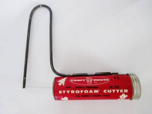

Edit: Here is a commercial device close to what you have in mind.

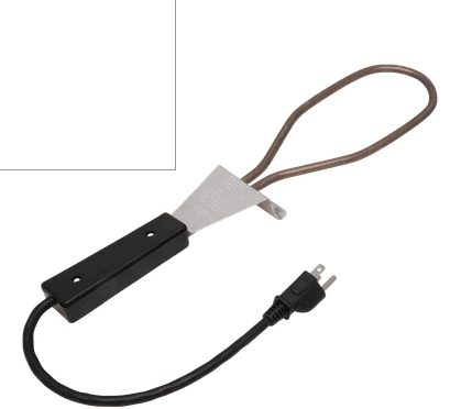

That's why electric charcoal lighters invariably have a plug and cord. This one's 500 watts, around only half a BTU per second,
which at 12 volts would be over forty amps.
