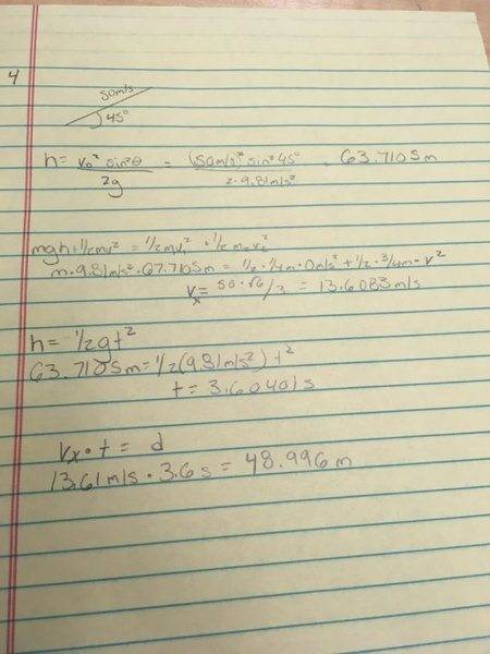

A firework is shot from the ground at a speed of 50 m/s and an angle of 45 degrees. At its highest point it blows up into two pieces due to internal forces. One piece (.25 mass) falls straight down to the ground below the explosion, where does the second piece land?
So first i used the equation of finding max height of projectile.
h=Vo^2sin^2(theta)/(2g)
h=63.7105 m
So then i would take the potential energy at the time of the explosion (mgh) and set it equal to the kinetic energies of the two pieces after the explosion? What would the velocity be of the falling mass? the x component of the velocity, zero?[/B]
Am i correct in assuming that the energy at the explosion is all potential as the velocity would be instantaneously zero?
If this is indeed the path to the solution then i found the velocity of the 3/4 mass to be 13.6 m/s for 3.6 seconds (found in freefall equation) and its displacement to be 49.04 m from the mass that fell to the ground.
Is this the problem statement exactly as posed? Is there an accompanying illustration?
You cannot use conservation of energy, it is explicitly stated that there is a release of internal energy in the explosion.
Which velocity are you referring to? The firework was launched at an angle of 45°...

I was understanding that because the explosion came from forces inside the system then the energy would be conserved as no external forces had acted on it.
The problem is missing vital information necessary to solve it.
Regardless, you cannot apply conservation of energy. The potential energy is the same before and after the explosion, it is just distributed as potential energy of the individual parts.

Okay so can I use the x component of the velocity?
m*50m/s*cos45=.25m*0m/s+.75m*v
with v=47.1405m/s and time being the same time of 3.6 sI found using the freefall equation?
Making distance from the fallen mass being 47.14m/s*3.6s=169.7m
Yes, that looks good.
