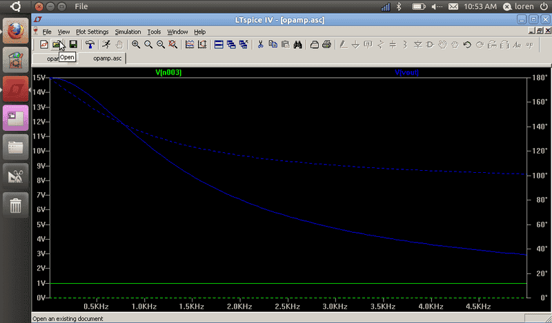

is anyone good with PSPICE/ORCAD?
I got to do a frequency sweep from 10 to 5000 Hz..and use Vin as sine with amplitude from 0.1 to 0.3 V.
I created the circuit using Vac and set the first parameter to 0.1, and bottom to 0.2 which i believe creates an offset with amplitude +/- 0.1? Not really sure, rest of circuit I was able to setup the op-amp, resistors, capacitors etc..
Is it ok to use Vac as I mentioned and then performing PSPICE simulation using AC sweep simulation profile?
well, i don't know how to vary the voltage at the same time as the frequency. but i attached a graph of 10-5k frequency with 1V

Why am I getting different results for basically the same circuit configuration? It seems Multisim is closer to the actual overall gain 300k/20k = 15 v/v, but orcad isn't giving me that =(
make sure you pay attention to your y-axis units. Looks like multisim is in magnitude while orcad is in volts. if you are using .1 volts they both seem to be the same. . .
thanks lorenb that was my mistake i had a 0.1 v peak AC source...anyone know how to implement a 0.1-0.3 sine AC signal? will that really affect the graphs tho?
*bump and help on how to make a 0.1-0.3 sine AC signal?
AC signals that do not oscillate around 0 merely have a DC offset. Put a 0.2V DC source in series with a 0.1V (amplitude) sin AC signal and you should get a 0.1-0.3 sin AC signal i.e 0.2V +/- 0.1V = 0.1-0.3
