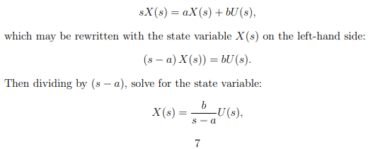

In the example for first-order differentials, i had to reverse the process as the source started from state-space equations to find the differentials, while I am doing the opposite. The steps i have taken are:

From here I figured this would be a reasonable way to find the state variable. Is this a reasonable approach? Although I believe i should change the name of c on either sides as they are probably not equal.
The next steps would basically be reversing the steps of the image i attached from the source you sent, but it gives me a second order differential with X'' and V'' in the equation after the inverse laplace, and I don't know if any of it makes sense at this point.
If i can have deeper guidance that is more related to my specific problem it would really help out further
